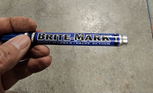

I found out that the Automotive Refinishing shops that we supply use these for touch-ups.
The guys I work with made me ‘one’ for layouts.
They filled it with ‘PPG’ ALK-200 - blue paint.

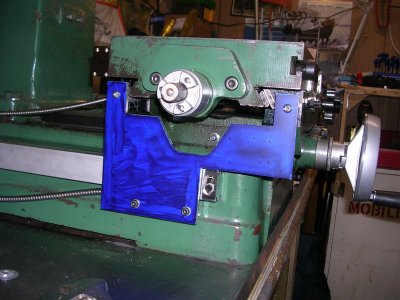

This is a DRO scale mounting bracket I made for my mill. It's made of 1/4" aluminum plate. I laid out the required shape using layout fluid and a scribe (pointy instrument). The layout fluid makes the scribe marks highly visible. I then cut the bracket out by following the scribe lines.
Does that make sense?
So two different functions?
A layout function where you 'paint' the surface and then scribe away that paint on the lines that you want to cut etc. Presumably it is easier to make these scribe marks in the 'paint' than in the metal itself. And the colour makes the lines easier to see than just scratches?
And a fit function where you use the fluid to show the groves / lands (high and low places) in a fitting that should be flush all over? Again, the colour making everything easier to see?
