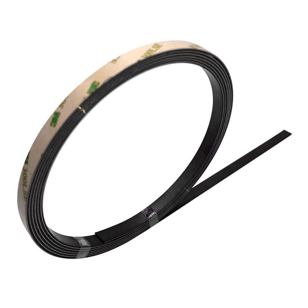

The scale is a magnetic tape that is stuck on in two layers.
This is the kit I'm stealing inspiration from:
The reason I went with Aikron DRO is it was slightly cheaper and the display has a data output option. The data output option was important to me because I would like to install a constant SFM controller (arduino) when I install a VFD in the next couple months.
I think there are some model engineer forums that discuss various DRO options to be compatible with the taper turning attachment, including mounting a magnetic tape without a shield behind the apron on the operator side.

I've seen the magnetic tape sold alone, and I've seen it come with a separate stainless steel tape. When sold with the stainless tape, is that to be a backer, or to go in front to protect the magnetic tape from crap and wear?
I suppose if I buy a meter of tape and only need 150mm I have some spare tape so it doesn't matter too much... but I'd like to know none the less.
