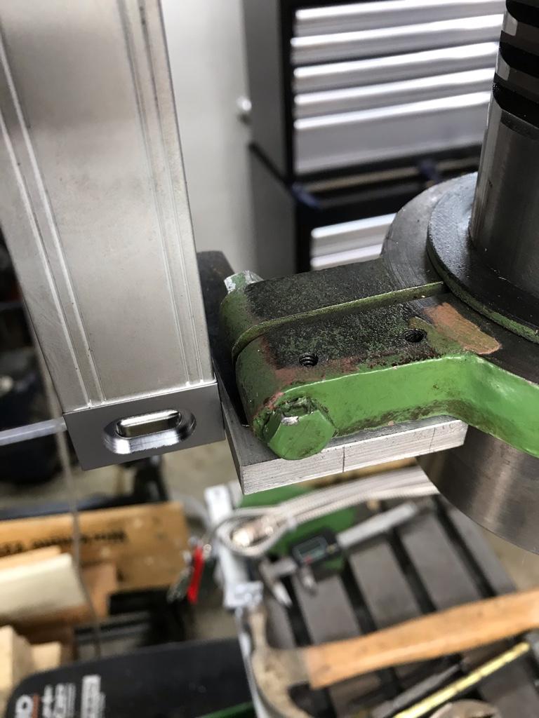

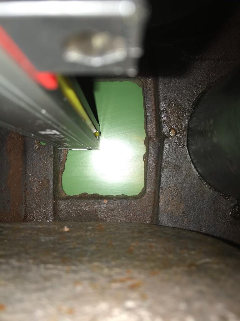

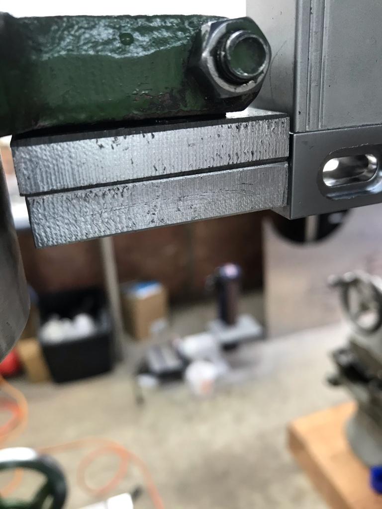

Took some time today and got the Z-axis scale installed.
(Edited to correct my brain stall when I said Y-axis originally.)
Drilled and tapped the spindle yoke and made a mounting block.
Discovered that when I put the reader head and end cap back on the scale hit the casting on the inside when the spindle was fully retracted.
I thought about taking the cover off and grinding back the casting but decided to add another block.
Made some brackets to hold the reader head. Used one of the holes for the sheet metal cover to attach it to the casting.
All that’s left is to tidy up the cables.
I’m really pleased at how it came together.

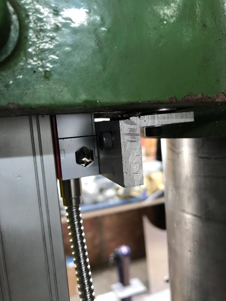

Make sure all of your scale readers are attached with two screws and Loctite them. I attached my "Z-AXIS" reader with one screw due to a lack of bracket material and recently it has been flickering readings +-0.001". I'm fabricating a bracket and fixing that as we speak.

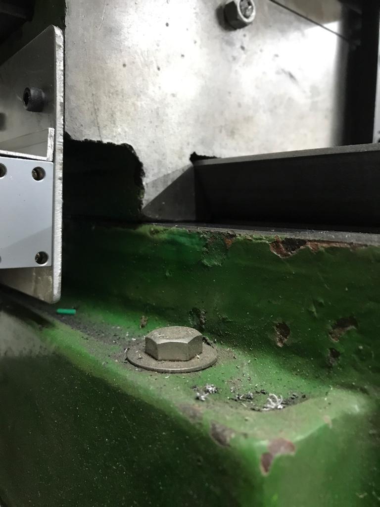

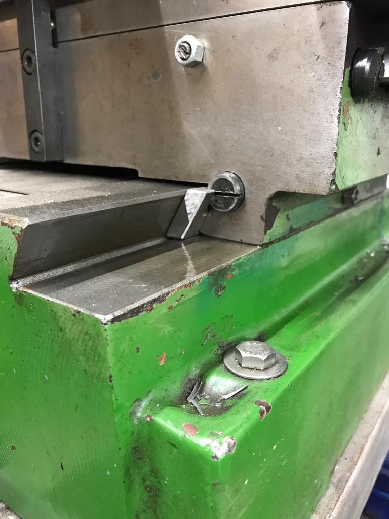

Here you go, nothing to write home about.
I added that bracket. The reader was originally mounted with the top screw only. Even with the bracket I register 0.0002" by pinching the scale and reader together. Flex in the scale as far as I can tell. Try that on your setup if you can.

Ha, the more I study your y-axis scale install the more differences I spot between our machines:confused: I think I'm going to have to take a different approach.
YYCHM
(Craig)

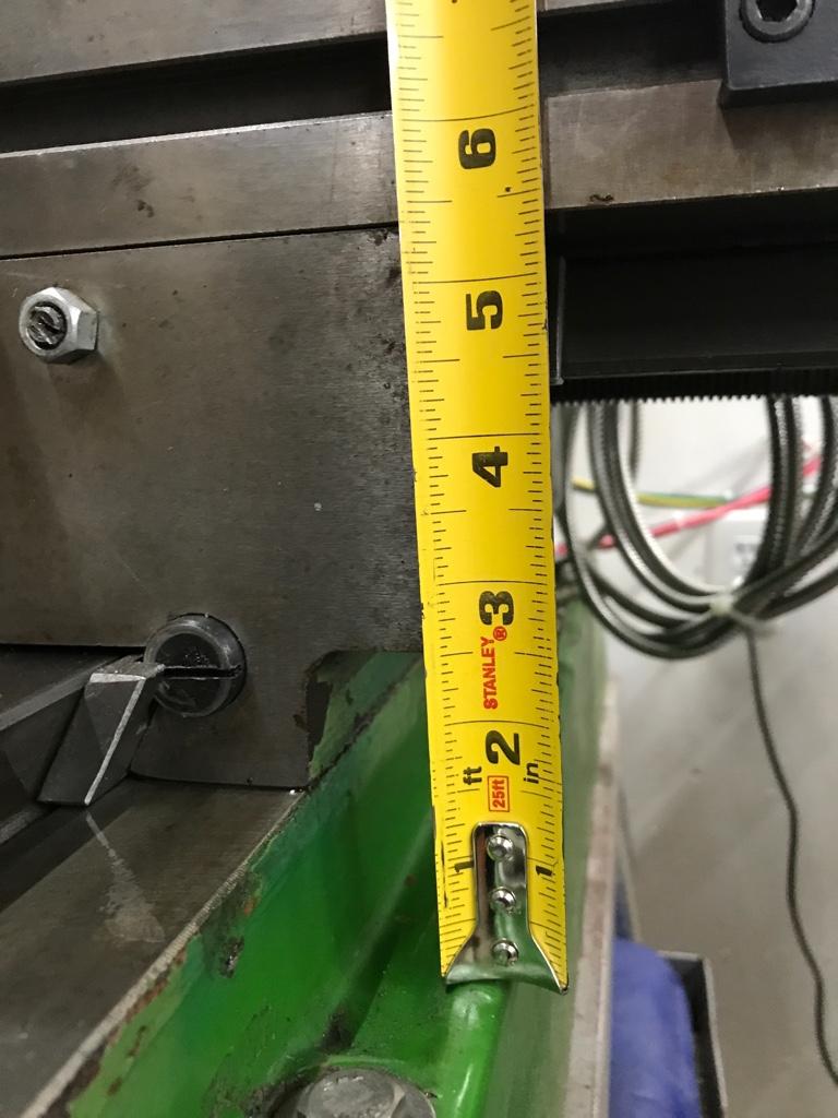

Definitely not as much thickness on your Y axis table.
I can measure mine if you want.
That and your base/column are different. Where are your column mounting bolts? Are the recessed? You have 4 x-axis screw cap mounting bolts, I only have two. Look at the steps in my base compared to yours.
DavidR8
Scrap maker
YYCHM
(Craig)
Ya, different. Look at my saddle compared to yours. Different again, it's recessed.
YYCHM
(Craig)
How did you reattach your y-axis swarf cover after the x-axis scale was installed?
