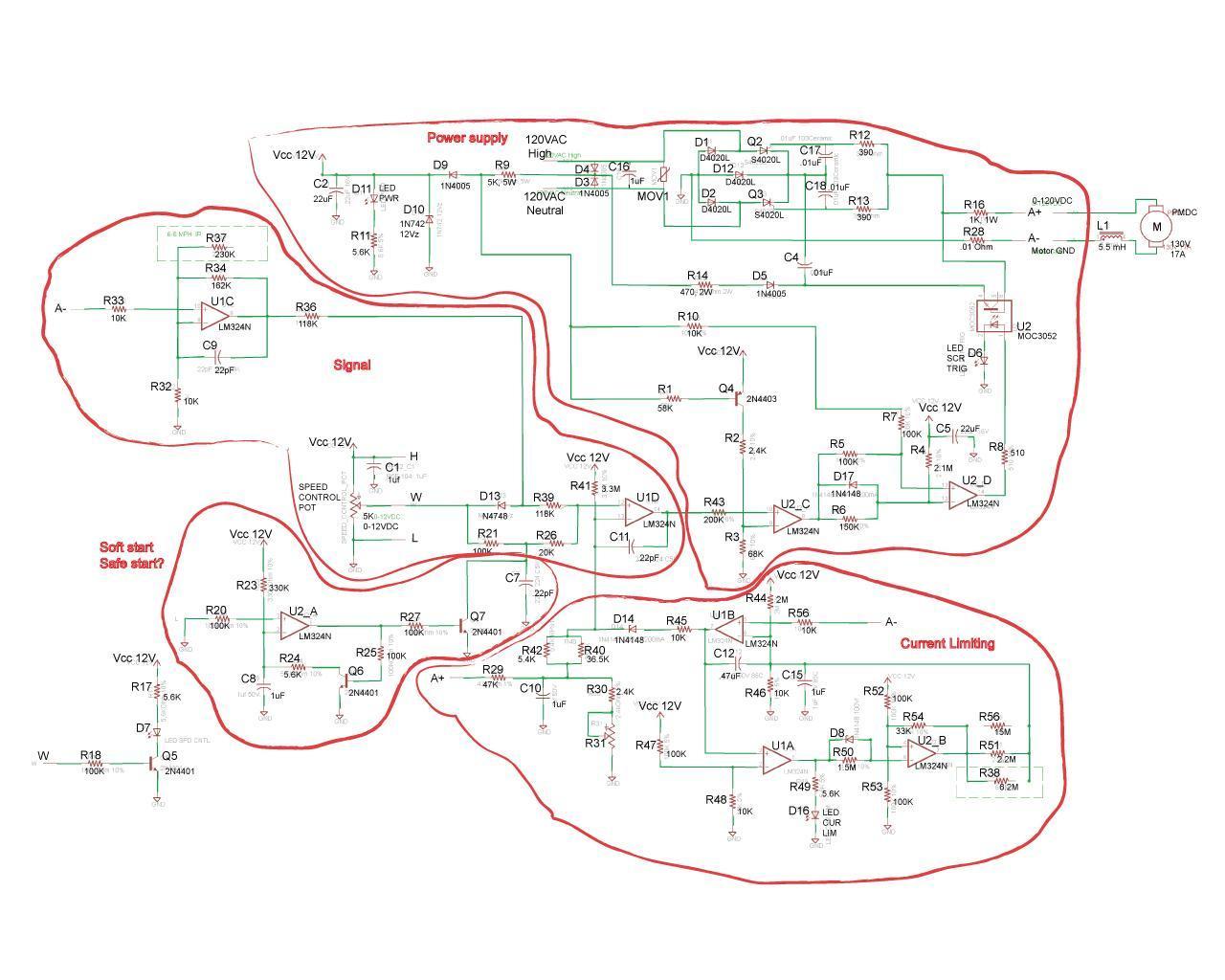

A search on line for treadmill speed control schematics and I find this: Notice 5K pot!
5.7 is well within 20% of 5 so I'm with you on that one John.
Furthermore, this application is just like I described earlier - it's just being used as a voltage divider with one end at circuit voltage and the other at ground. If this circuit is anything like the subject circuit, 5K should work just fine.

from that schematic the 5k pot looks like its being used as a voltage divider to me, i would run what ever pot you have between 5k-100k

testing would prove it, but i believe it would be the same the voltage divider (pot) its just a reference to the op amp circuitry, changing the value of the pot doesn't really do anything for what the op amp see's, its going to be a linear scale no matter what
my bet would be that the pulse width is not wide enough at the very low end to overcome what ever friction/inertia is required to start the motor rotating, but once the motor is rotating you dont need that initial "kick" to get it going any more and that is why you can slow it down below where you are able to get the motor started
im not to sure what the solution would be, maybe gear reduction to allow that higher initial rpm to be use full ? or possibly there may be a way to do it with discrete components that allows you to give the motor the initial pulse width to get it going and immediately drop back to where you're pot is.....however that's definitely beyond my skills.....with some playing around you might be able to code a microcontroller to give it that initial bump for the first few milliseconds
that circuit from what knowledge i have is just a simple pwm deal, nothing fancy....5% voltage divider in (pot) 5% pwm out kinda thing
