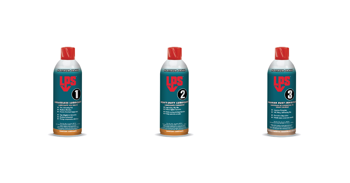

I'd love to find a light grease or spray lubricant that could be applied to internal or external parts that would last 20 years or so without becoming a problem of its own.
How about the LPS line of products? The #3 is the waxiest and stays around a long time. Quite expensive, but they work very well.
I put that S**T on everything. :D
The underside gets a coat prior to the winter, every winter, I have also used lanolin cut with mineral spirits at 50/50 and achieved the same results.
Some folks use that fluidfilm stuff, And I suppose that's also a mixture similar to LPS 3 and or lanolin.
I bought my stash in bulk, BULK is the keyword here.
A word of advice to anyone using LPS 2. It will eventually harden to something like varnish. Just be aware of that before you use it. I have seen it used in places where it made things difficult to take things apart later. LPS 3 is great for resisting corrosion. It remains kind of waxy. These products tend to be expensive in spray cans but reasonable when bought by the gallon. You can fill your own bottles with it.
