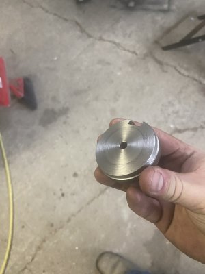

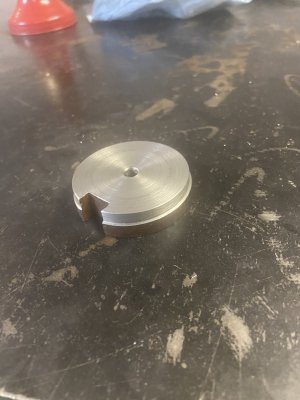

so I had a couple minutes after work here and I threw that cookie in the lathe and did a couple operations on it.
The surface finish is consistently excellent, especially on facing cuts.

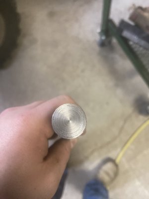

Known Mild steel I’ve noticed is a little bit “gummy” looking when I face it, but this stuff faces beautifully. See attached mild steel face picture as well.
It likes a lower rpm to be cut at then the mild steel I did in a similar diameter when making a part for my mill.
I drilled through the center drill hole and I burnt a drill bit up in the process. Lowered RPM and tried again with sharp bit, worked.
Not sure what to think.
I don’t have a known bar of alloy steel to experiment with and I’m new to machining so I’ve never machined it before to compare to mild.
Any thoughts?

BaitMaster, just run with that shafting! Start your ENGINE! Use it. You have already found out a few things just by turning it.
