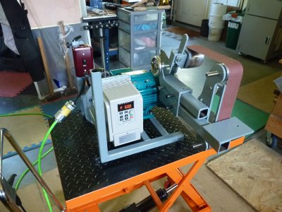

David - hope you don't mind a bit of a hijack here, didn't see a reason to start a new thread.
Here's my grinder, outside of the colour it looks pretty much like the video. The only thing I added was an DPDT on/off switch for the 240v as the VFD doesn't have an on/off button.
Even with a 1.5hp 3ph motor it doesn't take a heavy push to bog it down but otherwise it does work well.

I have that same vfd on my lathe, i dont think it is sealed, might want to put some kind of filter material over the ?ports?vents? All that electrically conductive dust youll be making might find its way in and burn the vfd out
Um……….run/stop ? Am I missing something ?
Although I'd guess that they exist, I have not run across a VFD that has an on/off yet. Run, Stop, Reverse - yes. On/off - no.
A switch in the input power line is simple and serves that purpose well.
