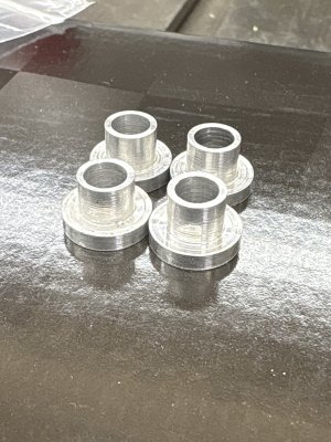

Made some bushings for a steering damper as a favour for a local motorcycle club member.
12mm major diameter
8mm minor diameter
6mm bore
6mm long shoulder.
Smallest parts I’ve made.

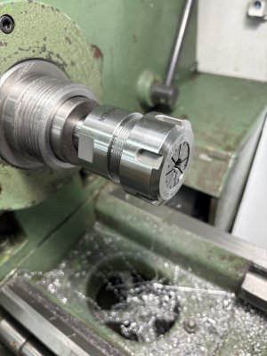

My quick and dirty ER32 collet chuck worked great.
