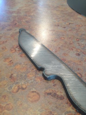

Test cut I added just over 1/16" to the blade profile and circled the tip so I can grind away the heat effected zone. These pieces are not 100% hardened yet and will have to figure that out later on. I have a guy who just invested $8800 on custom made fully automated grinders designed for profiling and sharpening the blades. I'll post a video if I ever get the chance.

just cutting the blanks and supplying the materials for now I have programmed 27 different profiles so far

re your comment about leaving a boundary kerf for heat affected zone, I though that's why maybe the profiling would maybe be preferred by water-jetting. Is it a cost thing or some other reason?

I get to keep all the cut offs, will definitely try to find a use for them, I'm thinking a machinist could do a lot better job with the small cut offs then I could. Water jet is definitely better but cost wise, and wait times to get it done are a pain. Since I have my own cnc plasma I can cut the profile within minutes of him ordering it and with his fancy grinders its just an extra minute or two to grind down the extra material.

I will also be cutting completely under water once I get my jig set up to reduce the heat effected zone even more. I usually submerge cut all my stainless, I'll have to post a video of the process
