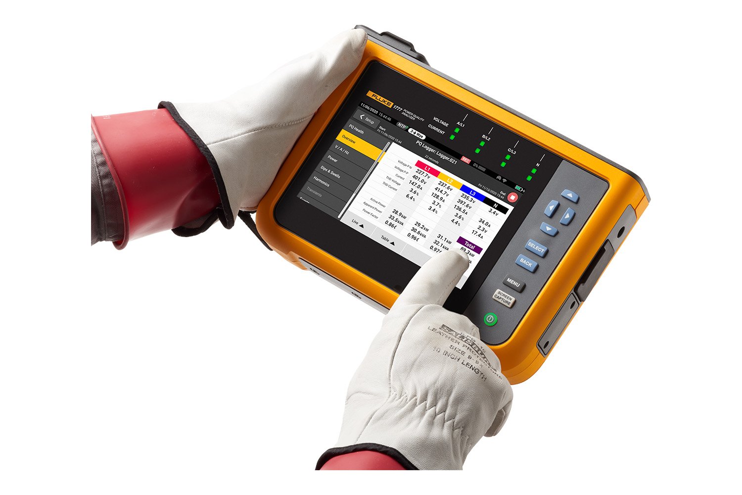

An oscilloscope would not be particularly useful to evaluate this problem.
The correct tool for this is a power quality meter/recorder. We designed and sold them in large quantities to PG&E. Power utilities have these and if you complain they might come out and leave one for a week so they can assess.
In general the power system frequency changes very very slowly +/-0.05Hz, but typically less and is corrected at the end of the day to keep the synchronous clocks on time. The entire grid and all the direct connected synchronous motors are in sync so it's not possible to have the frequency wandering in one part of the grid relative to the grid. Actually motor speed will vary with load/slip but typically about 50RPM for a 4 pole motor.
Voltage does vary all the time and by much more than frequency.
I'm quite surprised by that comment. I agree that you won't be able to see frequency shifts. Even if they occur, they are very low level as you pointed out. But voltage changes, cycle anomalies, and noise ought to be easy to see if they happen as often as Peter suggests.
@PeterT - I have to say that I doubt your issue is power quality. None-the-less, sometimes you just have to check.
I think that voltage changes, system noise, and cycle anomalies should be easy to see unless they are very sporadic. To see sporadic changes, you have to be watching when they happen - hence one of the many values of power quality monitor recorders. But it sounds like your problem is pretty usual / routine. Therefore, I would have thought a scope would rather easily show major voltage and noise issues if they are present. And for what it's worth, I don't think minor frequency shifts of the type that can occur on the grid would cause the problems you are experiencing. As SlowPoke says, they are very very minor - tiny fractions of a percent - that have to get corrected every so often anyway. It's not that it can't happen, it's more like it just doesn't happen! The grid won't allow it.
