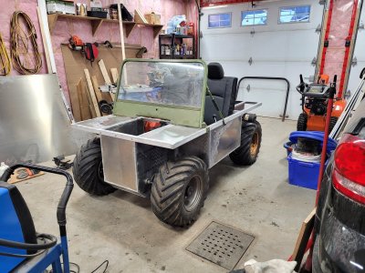

This is by no means a precision or speed machine I have built. It's more like a floating tank really. This is an older pic of the beast, its come a ways sinxe then.
