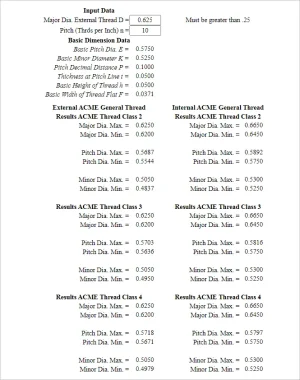

The screw portion is under 8" so I'm not sure the follow will be needed. As for DOC, I have a new nut nut made so, as RobinHood suggests, I was going to use it for the thread gage. I have some unknown rod so I'll make a couple of test pieces to get the process right. I'll also try one at .497 to see how much difference .003 under will be.
I've seen the thread mics but I'm not into a production run so I think I can better use the $ for tooling, and I might need the $ just to buy the rod.
MSM just quoted me $55 for .625 x 36" of 4140 so that's not cheap, it's not even inexpensive.
This link might be useful for your sizing. Its probably in the The Book but then I'd have to get up & find my other glasses :/
https://www.engineersedge.com/hardware/acme-threads-calculator.htm
I've never really paid attention to this before but the min/max tolerance on the major diameter (0.6250-0.6200) represents a tighter range than the Class II example pitch diameter (0.5687-0.5544). I'm pretty sure V-threads around this size are the other way round, no?

@YotaBota - looks like the chart Peter posted allows for up to 0.005” under the major diameter with no ill affects on the fit. You should be good with only 0.003” and like I mentioned earlier check your fit to be sure you keep things snug.

The chart from Peter helps in pointing out that the OD is a non-critical dimension- it does not touch anything. I believe the sloping sides of the thread are what determines the fit. when cutting an acme thread, there is quite a bit of tool in contact with the material - there is going to be deflection. Perhaps with a piece only being 8" long X 1/2 minor dia, the deflection of the finish pass will not be objectionable? My experience on cut to fit with a "long" thread is that it is pretty easy to get the starting end correct, but then the mid-region is too tight.
Lots of great ideas shared here, looking forward to hear how it turns out.
I wouldn't say OD is non-critical. Its a min/max range for that class of fit. If you are outside this range, there will likely be a downside. But like I was saying strikes me as odd is the OD min/max tolerance range is tighter than the pitch diameter tolerance, which is opposite to vee theads. I don't have experience turning acme, there must be a reason.
