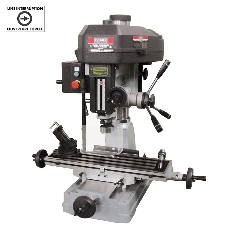

It looks like you could remove the motor, head, cross slides, motor and dolly/carry the King PDM-30 into the basement with a buddy???Let me know if I am just dreaming…lol

i have a pdm 30, if you took the head off you and another guy could probably carry it, or dolly it down some stairs

i would estimate close to half of the weight is in the head/motor/column, take that bit apart and it would be manageable to get the pieces down the stairs on a stair dolley

I brought my pdm-30 into the basement alone no problem and I am a 140lb weakling , break it down into sizes you can carry, I removed the column from the base others didn't but with a buddy should be piece of cake. I was a bit worried before as well but it was unfounded.

I'm ok with my king pdm30, belt changes kinda suck, and you need to work around the round column z axis issue, but for the money I would rather have a 2hp mill over a 3/4 any day
I have a VFD and a 3ph motor sitting that will eliminate most of the belt changes, once that is done It should get rid of that complaint
