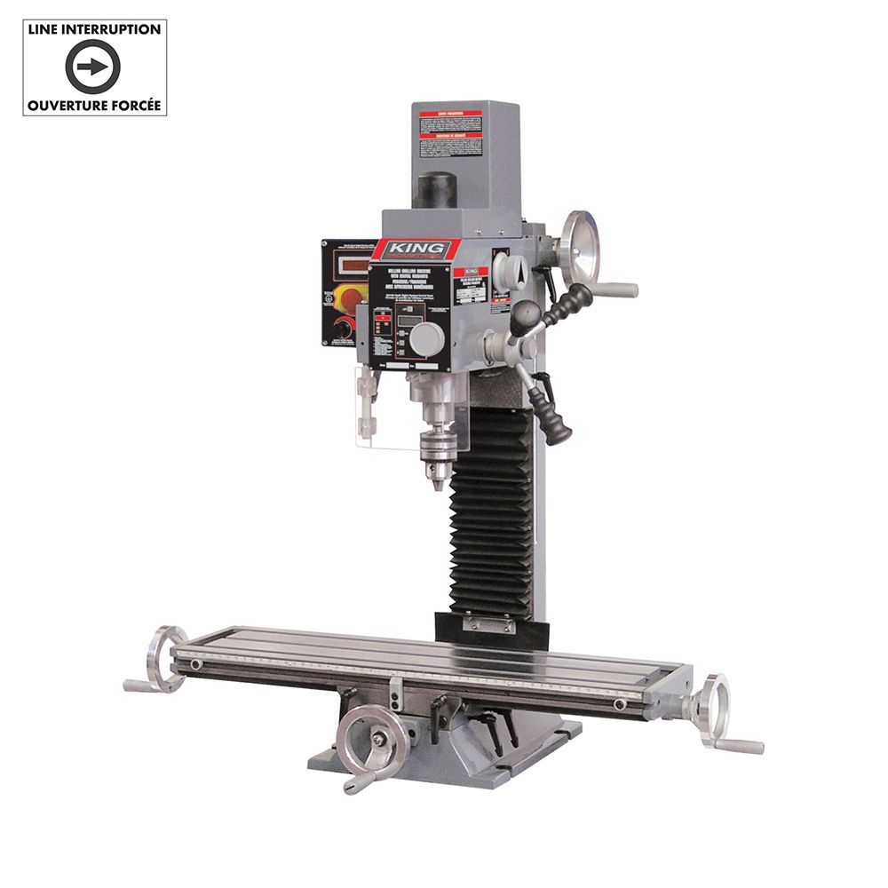

I am on the fence between the made in china Craftex and made in Taiwan King Canada vertical mills. Specific models are King MODEL: KC-20VS-2 and the Craftex r8 cx600. I want simple and reliable. Please help me by giving me your opinions and personal experiences. I want to buy one really soon.

The king machine looks to me to have ~7" more longitudinal travel (11" vs 18 7/8"). That's pretty substantial. (20” x 7” table working area on the craftex vs 7-1/16” x 27-1/2” on the king).

I have been planning on the CX600. They are both basicly the same price right now.
A couple of differences that pop out:
Craftex comes with a stand (for now)
King has 1HP motor vs 3/4hp
king has 7“ more longitudinal travel.
My only hesitation is support. I have heard King is very poor support (I have never dealt with them personally). Craftex is not perfect, but I have a couple of they’re machines and have always received good support.
If i had all my pennies saved up right now, I would lean toward the King.

So are they both plastic gears? I want to play machinist not play tool repair mechanic on a brand new machine. I guess this is why the brushless models that are belt driven are so expensive…
torx10
Member
My King KC-20VS-2 definitely has plastic gears, can't speak for the Craftex CX600. Due to inadequate workpiece holding (operator inexperience!) the workpiece shifted during a heavy cut and stalled the motor. The photo shows the damage to one of the plastic gears. The local dealer supplied a new gear under warranty, and it wasn't that hard to replace. But the mill still has a noisy low range, so another plastic gear, deeper inside and harder to change, was also damaged and is on order. Weiss, who seems to be the Chinese maker, admits these plastic gears are breakage prone in their promotion of their newer, DC motor belt drive mills. The Grizzly G0704 looks to be the same mill, so they have the gears available if King doesn't. But I would have gone with a different mill if I'd known about the plastic gear issue.
A few years ago, I was in line to buy a Craftex. The salesman talked me out of it because of the plastic gear.
But I understand metal replacements are available today.
Even if not, use your mill with plastic gears to make a steel one!

the king sounds like the better machine for the money, i havent had to deal with thier customer service so i cant speak to that, but that is probably the one i would go with of the two, if looking new
if your looking at that size range of mill your probably going to have to live with plastic gears until you buy metal ones, or like @Susquatch said, make your own ;) thats a good mill project
I agree with all of the above..... With the slight exception of one word.... It would make a GREAT mill project...... Not nearly as difficult as one would think, and a great confidence builder when you are done.
