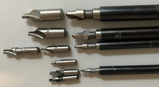

I have this set from DoAll. Counterbores are interchangeable in the mandrels with a taper interface. Also includes bell mouth countersinks that fit the same mandrels.
These are old so not sure if DoAll still offers them.

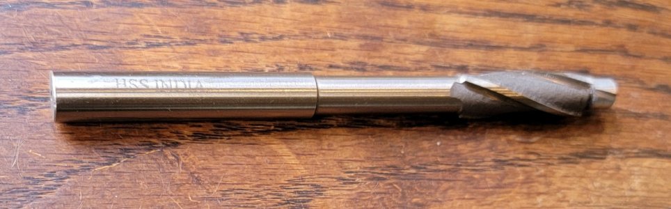

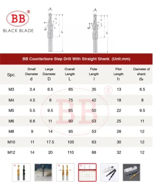

I've sampled some of the Ali offerings, BB might have been one of them. I've generally been happy with their tooling. The thing I noticed is that there is seems to be variation in the pilots. Some are intended to drill & CB into native material in one operation. Some I think are meant to use an existing hole to guide but mainly its a CB cutting tool (the guides on those have kind of a chip relief but not really a cutting lip like a drill). Clearance holes come in different flavors of course, so I'm not exactly sure if there is intent to match so the pilot is guiding but not rubbing or too loose? And probably there are also standards to how much diameter head relief you want too. The all-in-one style have certain max drill depths that may or may not match your application. I must admit I use endmills over the clearance hole pretty often.

I have a set from 1/4" to 5/8". I broke the pilot on the 1/4" first time I used it. (The clearance hole was probably too small, so my fault} I prefer to use and endmill.

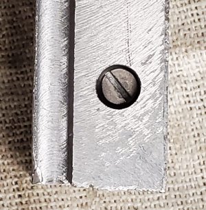

So a quick check with the caliper on the 3mm counter bore and I get 3.37mm for the pilot hole and 5.81mm for the counter bore. Tough to measure with only 3 flutes but probably close enough.
Now is it close enough for the counter bores I make for my amateur machining. Probably. Is it close enough for something that goes into space or the air and peoples lives depend on? Absolutely no idea.
And just to add to this. Using that 3mm counter bore I first drilled a hole in cast aluminum with a 3.2mm drill. The hole was over 3.3mm since the pilot of the counter bore slide in with essentially no clearance but also didn't stick.
Then, with lots of WD-40 and 300 RPM I drilled the counter bore. It measures with the caliper at about 6mm. Likely my chuck has just enough runout to make the holes a bit bigger?
Anyway, here's a filister slotted head 3mm screw sitting in the hole. One of the charts I have says medium clearance for a 3mm screw is about 3.4mm so I think overall this is probably correct?

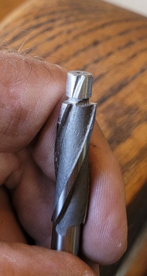

Here is a photo of a 1/4 screw counterbore. It was used once. I hated it. The pilot is 0.282 which will not go into a 1/4" hole. The head counterbore is 0.425 which is way too much. It has no provision for a root fillet. Basically, it just sucks and was a waste of money. I have a #10, a 1/4, a 3/8, and a half inch counterbore in that set. They are all junk in my opinion.
Here is a 3/8 Counterbore from a much older set that came with my mill/drill. It has the same problems, but the pilot cutting edge is a bit more aggressive. Even so, it isn't aggressive enough and doesn't work either.

Let me see if I can add some insight to the counterbores you have Susquach.
They are designed for .030 clearance on both the drilled hole and the counterbore itself.
That is why it will not go into a 1/4" drilled hole.
You will need to drill the hole with a 9/32 drill then the counterbore will work as designed. The flute diameter will also give you about .030 clearance for the SHCS diameter.
I'm pretty sure if you measure the 1/4" counterbore you have it will measure .281 and flutes will be close to .375
Chinesium counterbores can vary in clearance sizes... But you like to shoot for .030 clearance when doing counterbores for SHCS's
Just need to run them at low RPM in steel.
