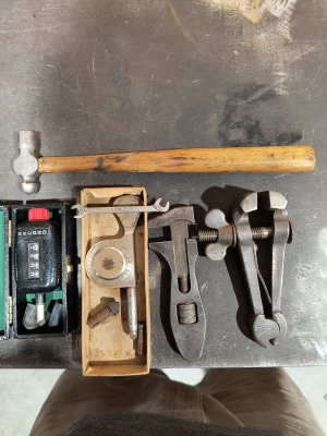

I have nothing too crazy got some of neat stuff I've found over the years. Tiny hammer for tiny trouble shooting. Same as my 13/64 wrench for those hard to reach nuts.

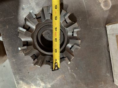

I got this 6" shell mill that I'm gonna use on my mill when I find 2" 40 taper holder
for it lol.

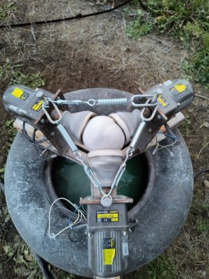

Not sure if it counts but I don't imagine many people have a homemade sphere machine laying around.

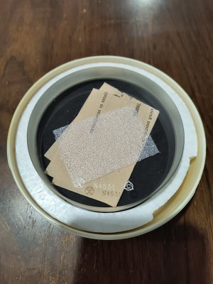

O ye last but not least I got a small optical flat from USSR
I can only assume it makes spheres by spinning those cups over the workpiece...as the workpiece rotates?
ornamental concrete bra filler?
Basically ye the cups do the cutting and the action of the rock to turning random patterns makes it round. If rock gets stuck or makes repeating patterns you get weird looking shapes.
Ehhh just thought it would be neat and the wife is into lapidary so figured why not make one and screw around. Makes fun little gifts to throw at people.

Interesting ..... what are the cups, and how are they charge with an abrasive like a lap or more like a diamond filled resin like a grinding wheel?

My Dad would have loved that. He was into petrology and lapidary for many years. I'm guessing the cutting is by the rotating diamond cups that are flooded with water, The water drains into the tank below (the tire) and is pumped back up.

I used diamond core drill segments and silver soldered then onto some cast iron cups for the roughing cups
And for polishing I cut up some diamond resin pads for counter top resurfacing and glued them to more pipe fittings. I need to get the wife to 3d print a cup set I can glue velcro too so I can just modify the pads and then just use same cups not have bunch of cups I go to switch every stage.
There is sphere machines that use a slurry with grit to do all the cutting and polishing but they are bit slower and usually use a chain that sits on sphere and one of the cups and the slurry kinda clings to chain and makes its way onto sphere.
The tire was just something convenient to set the machine on and I have a garden house rubber banded to one of the motors and just cracked the valve to drop feed sphere during polishing. Roughing I just run dry.

It's pretty fast build less then 6 hours I would guess and biggest part cost is the motors are around 100$ a piece. The other big cost is the cups.
Depending on if you make em or buy them pre made. If I were to budget to build another one including buying premade cups and polishing pads I would budget around 800$ and that should get you well set up for making 2"-4" spheres.
Only draw back is your limited to the size of your cups for what you can make.
The other thing that effects cost is size of spheres you want to make to begin with I made this unit for around 120$ as a prototype but ordered too small of motors for it to be useful for anything but polishing really.
Or if you wanted to get crafty you can make use of the plethora of outdated 12v drills available for less then 20$ a pop or maybe get few for free from e waste drop off.

The work must be fairly round to start with? Presented with a rock, how do you get it to the point of loading in the polisher?
Round ish doesn't have to be perfect but if too out of round it has tendancy to jump out of cups. I kinda just shape the rocks with tile cutter then rough a bit then remove any lumps with diamond zipcut then just check with calipers so make sure rock isn't turning into egg shape or something weird.

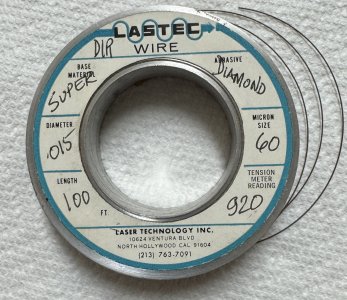

Diamond coated wire
Used to cut tightly compressed powdered high explosives to inspect for voids and/or striations in the finished product.
