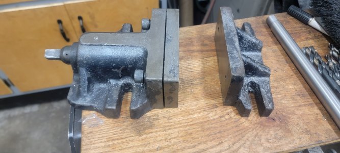

Vertical vise that triples as angle plate and two-piece table vise.
I have one like that made by Bridgeport.
Like many other old vises, the handle is missing. But an old 1/4 Allen drive works fine.
I've not taken it apart yet or cleaned it up. Project 42z6b.
But I can only imagine the gear train it must have inside it to drive the double lead screws.
I must find such an animal

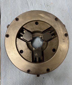

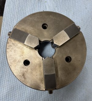

1) A 3J chuck without a scroll - but the jaws still move in unison. This system uses a ring gear & pinions driving precision square threads to move the jaws.

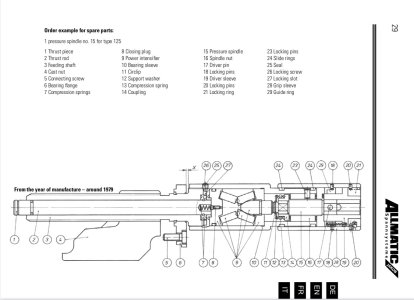

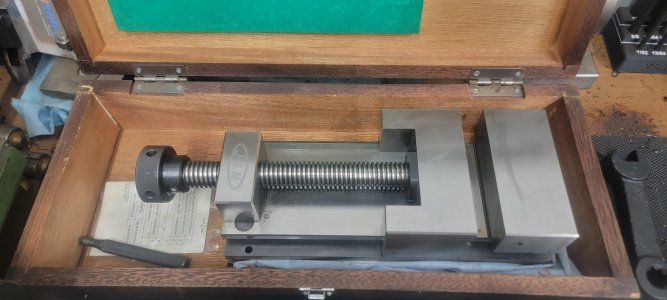

2) Allmatic precision force multiplication / force limiting vice. Here is the link to the manufacturer:
A cross-section of the mechanism.

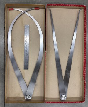

3) 2 foot inside / outside calipers.

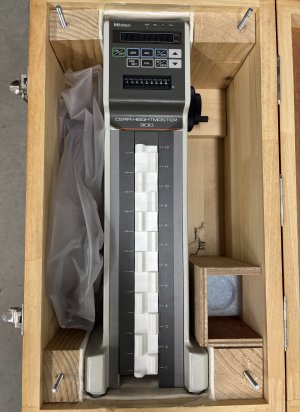

4) Super high precision height setting standard (it is not 100% functional - something is wrong with the laser inside; maybe someday I’ll send it in to Mitutoyo to get repaired).

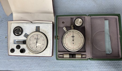

5) Some old school mechanical rpm measuring devices; they both still work perfectly.

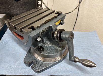

6) A precision swivel / tilting table Made in Japan. It works well, but takes up a lot of head space on the mill table.

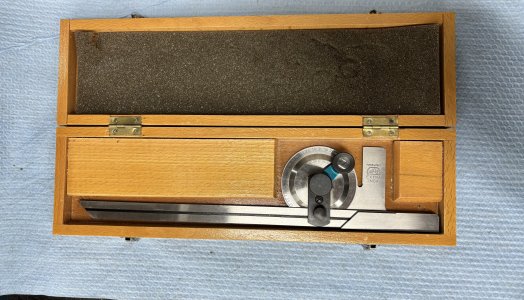

7) Precision angle measuring device; it reads to the arc minute and is very easy to read with the built-in loupe.

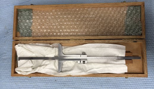

8) Etalon depth measuring calliper.

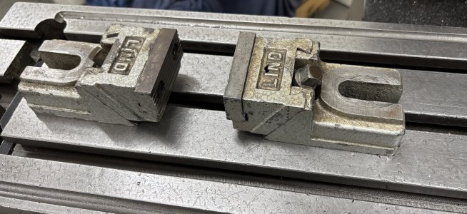

I have a pair of TE-CO toe clamps. (Thanks to @Stuart Samuel for putting me in contact with the seller during our Forum spring meet-up)
I tried them on the mill to hold a a large flat piece of steel. They worked great but that exercise made we wish i had another pair so i could clamp from 2 directions or locations.
A light went on this morning when i saw this picture (from Darren’s post above).
Oh so obvious - just clamp down a backstop and then use one of these to clamp towards it (just like a 2 piece vise).
Wow - Just overcame another brain fart!
