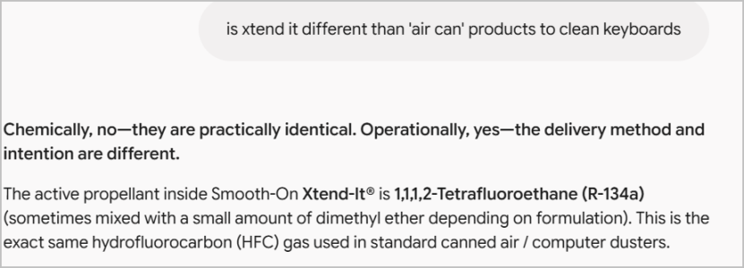

I'f its mostly related to exposure to air (oxygen) inside the can, there are gas blanket products. I use one called XTend it by Smooth On for their urethane resins but its crazy expensive. I must have deleted my AI query but there is a range of other products that could work. Apparently even some of the contents of 'canned air' inside those keyboard blasters contain something useful. Argon & some inert welding gasses work but less chance you have it kicking around. Do some Googling. Now if its like certain resins that just start forming long chains on their own due to age thats a different issue. Until recently I didnt know my 10 year old can of TremClad tar can be diluted with common paint thinner & away we go again. Kind of depends on the product.

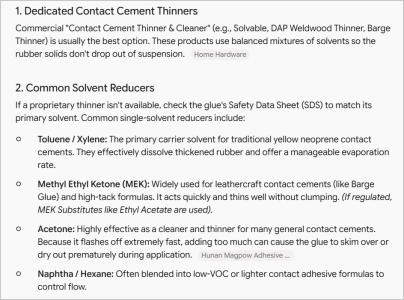

I might be thinking about something else where a guy thinned his product for whatever reason, but if you have any of these reducers kicking around, you could do a small sample test. Assuming its not already too far gone. Just add it in small % & make notes.
