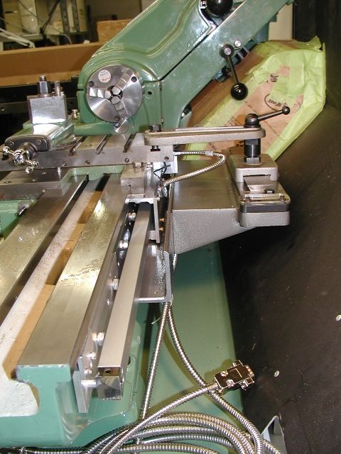

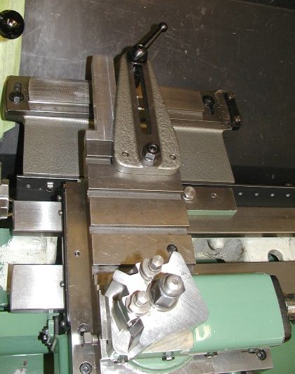

That's what I did on my Myford install. Glass scale on the back and magnetic in the cross slide. I think the glass scale on the back was the right choice because I don't worry at all about it getting it full of chips.
One thing to consider is whether or not your Z (longitudinal) axis scale choice will interfere with any aspirations for a taper attachment. I was considering trying to use a second magnetic scale on the front, in behind the apron to keep the possibility open for a taper attachment but I decided I'll probably never need one.
@Xyphota
I'm getting ahead of myself here since I'm doing a write-up on my Myford Super 7 and will cover this but if you have visions of putting a taper turn attachment on your ML7R then I think I have developed a suitable solution.
In a few short words, I added a 2-1/2 x 1/4", U shaped channel in between the bed and the TTA and hung a slim glass scale in the channel. I think you could still do it with a full size glass scale. It still uses all the Myford TTA parts and I haven't been able yet to see how moving the angle slide out has limited practical use of the TTA. All it did was change which T-slot the TTA arm is mounted in.
In total I drilled and tapped two holes and machined one groove in the cross slide for the whole DRO installation, the rest was bolt on.
Here's a sneak preview:
More to come in my write-up! :)
D :cool:
