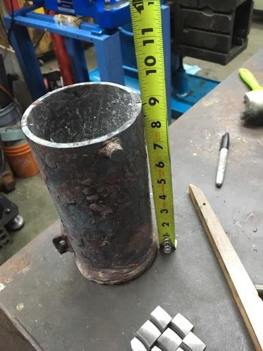

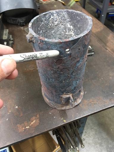

kevin.decelles
I went down a similar path , wanted a Frankenstein lug on either side, figured I would make a holder.......
But then I had a bad experience with my holder dropping 8lbs to the floor......... long story

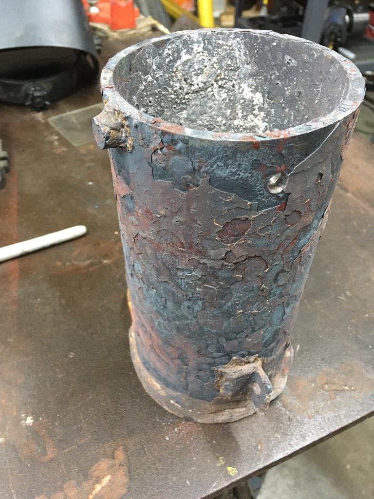

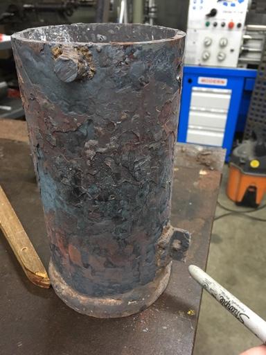

Here is a picture of my steel crucible that I’ve been using since 2001
U can see the lugs, never been used since. Instead I drilled a hole about 3/4 inch down and center ( see end of sharpie marker below)
And I welded a tang at the bottom with a hole. (See image below)

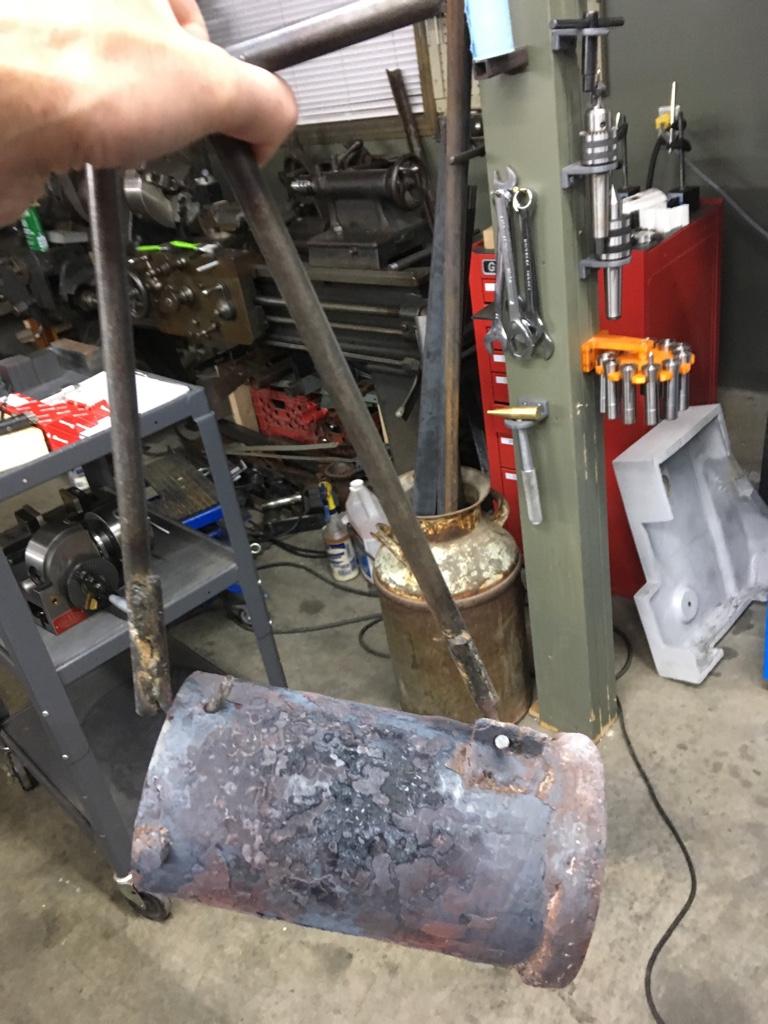

Using some simple hooks I can lift and pour by hooking both holes and articulating the pot
It’s primitive but bullet proof
It is time for a new pot though...... looking forward to your experience
