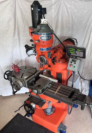

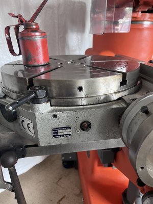

Scored a really clean Meca 16” rotary table recently to add to the collection. Weighs about 200lbs but finally got around to getting it onto the table with the engine hoist. Looks like I might need a stand-off extension for the turret on my Wells Index 887…..not a lot of clearance otherwise….now need to source an appropriate chuck to mount on this too…suggestions/pictures anyone?

By the time you get a chuck on there, it going to be bit crowded. 8in. or bigger chuck? You have a collection of rotary tables? I have 2, a 3in. and a 6in, possibly all I may need, but hay, never know.
Nice looking mill!

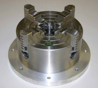

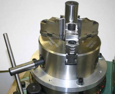

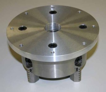

Mounting a plain back chuck is relatively easy with an adapter plate. Even if you have D-pins for a lathe setup you can temporarily remove them. Some plate considerations:
- bolt pattern to match your RT slots obviously
- be aware of height stack-up by the time you mount the plate + chuck + work, then tooling coming down from the top.
- a through hole in plate to allow stock or fixture arbors to extend into, otherwise stock length will bottom out on the plate (limited by your chuck body through hole)
- if you have different chucks with different bolt patterns, try & incorporate them both into one universal plate while you are locating & making holes anyways
- an afterthought unrelated to RT (not shown) depending on the size of the plate, mill 2 flats superimposed on the OD & that will allow you to clamp the plate + chuck in the mill vise. Or if you want to mount it to your mill table, figure out those T-slot spacing dimensions beforehand
