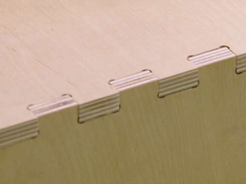

BUT I need a lot of storage now and I dislike expensive rolling metal tool chests. I was looking at options when I found a person who created tool chests out of laser cut 1/4" baltic birch plywood. They've released the files on thingiverse.
Such a tool box is appealing because plywood is inexpensive. It can help control moisture and protect tools within, and it is easy to work with.
If you omit the hardware that protrudes from the chest exterior such chests can be made to slip into a wall unit for large volume storage. You can add cheap laser cut plywood wood boxes, inserts and dividers to the drawers or custom foam cut outs.
Downside, laser cutting in low volumes is not cost effective unless you have a laser cutter.
So would anyone want to participate in a group order/build of one or more of these? Perhaps modifications, etc?

Interesting...I wonder if the design could be modified to be cut on a CNC router.
Im sure that it could... and you have one. Handy eh?
The tenons get rounded ends and the finger joints are simply rounded. It wouldn't be ideal but certainly doable. It is a few years since I looked at any furniture router joinery I'll have to start looking again.
I can make dividers etc using router table, and could likely make much of these with router but it is easier to have 10 or more kits made at a laser cutter place

I looked at the dxf files.
I can import them into fusion as sketches and then modify them to make them cuttable with cnc router by extending each sharp corner outwards at 45 degree angle with the smallest end mill typically used to cut out 1/4" plywood
TorontoBuilder
Not sure if my cnc router is big enough, but I would love to try these files. I could use a couple
@TorontoBuilder Doing box joints requires what they call “dog bones”. The cutter needs to only cut the radius of itself. I think my vectric software has a way to add these, based on your cutter size.
I knew they had a funky name but couldnt recall it.
What is the area of your router? The original laser this was designed to print on has an envelope of just under 24" x 36" so if your cutting envelope is larger you could cut this as laid out IF you adjusted and made dog bones in the corners. Tell me what dimeter you end mill is and I shall modify the file for you
