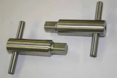

I really like using my twin, mini chuck keys on 4J. An easy home project to make them. They give you a much better feel for dialing in the jaws from 'way out' to within a thou very rapidly because you are adjusting 2 jaws simultaneously. That's more time efficient than in/out on 4 points. Your brain quickly develops a feel to micro-adjust one key the same as the other as they turn opposite one another. This not only makes the the requisite displacement adjustment, it gets very close to equalized jaw force on the part which is very important & overlooked. When its relatively firm & within say a thou, you're 95% there. Then tighten whichever remaining single jaw to move the needle last thou home. Rookie mode is jaws are tight being too far out like 5 or 10 thou. That's when the loosen/tighten iteration dance starts or getting impatient & bringing out the Gronk wrench.
Alright @PeterT ... You got my attention on that one.
How do these Twin mini-keys work and what does this contraption look like? Is that like some kind of external scroll? Does it have to be custom made for each chuck or is it adaptable to your chuck size? How much do you think it cost you to make it?
I am curious as a Prairie Magpie!
img_6745_edited-2-jpg.18843

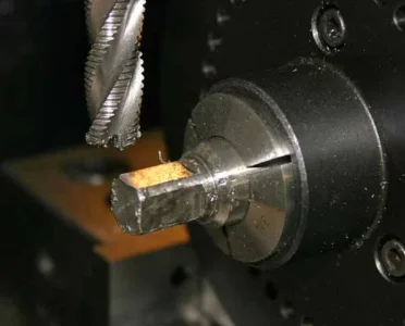

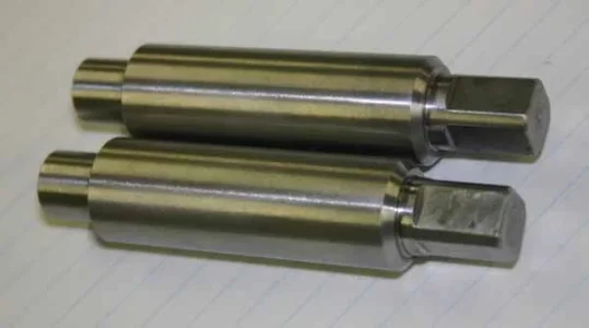

Hope I'm not overselling something dead simple. All I made was 2 identical chuck keys. They are shorter & more compact than the typical regular key so its comfortable to position your hands on either side of the 4J chuck (horizontally in a lathe vs up-down). Just insert them into the opposing key registers & rotate simultaneously. Obviously to displace the work they turn in reverse direction to one another dictated by the jaw screws, but your brain figures that out really quick. As you feel it tighten against the work you crack one open & tighten the other nudge-nudge mode. Everything else about dialing in is no different than regular 4J setup.
On initial setup setup, what I find is you can get real close if you just focus on the gap between an indicator tip positioned say 1mm away from work. Don't even look at the dial at this point. Just make the gap the same between the 2 jaw axis lines rotating 90-deg. You eye is amazingly good at distinguishing a gap. Then when you apply the indicator to the part, the needle will exhibit much less movement & center will be much more obvious. If its counting 2 revs one way or another (out by a lot) just drives you batty & wastes time. Using the reference circles in the chuck relative to jaws is another good initial visual cue.

Seriously?
That looks fully manual to me!
HUGE disappointment!
I thought we were talking a coordinating mechanism of some kind.
I don't want to be turning both of those at once myself. I prefer to get two hands on just one key at the top. I don't even like cranking a jaw from the side let alone two sides at once!
But ok, I guess the joke is on me.
