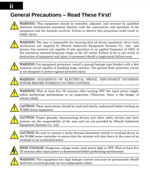

Unplug and wait perhaps 10-30 minutes. You can easily verify by measuring with DMM set to DCV (minimum range 400) on the DC bus terminals these are almost always available typically near the ac input terminals. Should be about 340Vdc when powered (assuming your source is 240V). You can watch it discharge.
Typical example shown below, every VFD will obviously have different terminal arrangement.
I don't recommend shorting the caps. You might damage something else in the circuit. I think @slow-poke has the right approach and @thestelster has the correct info for his Hitachi. Unless someone has solid reference material for your drives, I'd just unplug them for an hour or so. If And unless you know what you are doing, why not just unplug them from the wall one day and move them the next day. That's likely WAAAAY overkill but definitely safer than other methods too.

Every VFD I have handled, including the offshore ones, have a discharge resistor across each of the caps.
But to be absolutely sure, touch a 2.2K (2 watt, to 10 watt) resistor across the capacitor leads directly - using an insulated pair of needle nose pliers, please! You should not see a spark. If you do then there are no bleeder resistors in your circuit. You will have to touch the capacitor's leads several times to take out the bulk of the stored energy.
The Teco units I use expressly describe their bleeder resistors, and that 30 seconds is enough for the unit to be safe. Mine are 6 years old, so that time interval might be different....
