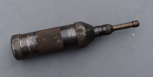

Wow that looks awfully familiar!!! I got the piece pictured below in a box of stuff that came with my lathe. When I first pulled it out I thought, what is this? Looks like a weird grease gun? Then I looked at the embossed "Wanner Made in Switzerland" I thought - hmmm - must be something good. But if its a grease gun how do I load it? I thought the back cap must unscrew. But dam no matter how hard I tried I couldn't get the back cap off! Well I thought pretty useless if I can't use it! But if its made in Switzerland I'm keeping it!!! :D
So how do you use one of these??? If its really an oiler do I refill by siphoning up oil??? Is it possible to clean out the inside???
I have ones similar looking, but don't actually have a Wanner. (just grabbed a web photo to show the general form factor) On mine the cap on the left side unscrews (as well as every other connection). Inside is a cup with a little chain you pull to remove it and then fill with oil.
Abnox was who I was thinking of, and their web site shows a grease gun and an oil gun. Not conclusive though....while yours looks like the grease gun, I have one that looks almost the same as yours and is for oil. (or maybe mine was for grease and is just being used for oil? no idea). Coincidentally I just took mine apart on the weekend, a threaded joint was leaking. They are a bit tricky as too much pressure will bend the parts. otoh, they shouldn't be that tight. A couple fabric style strap clamps might do?
