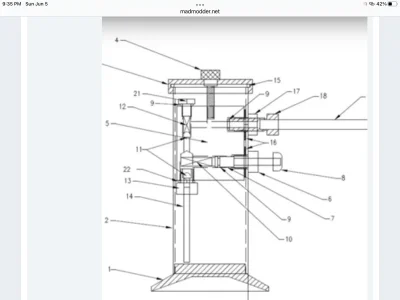

Do these work on ball oilers???
I'd say mostly no. You don't get much pressure with the finger pump style. The end could be modified (groove in the end) and it might get some oil in there, but for ball oilers on machines you need a high pressure gun like below. The cans aren't going to work like that cylindrical pump style. Thats were you get into Craig's $80 oilers....there's some really nice Swiss ones I've been pinning for, momentarily forget the brand, but they are a lot of money.
That would be good home shop project. One that doesn't leak and has different ends for different types of oilers (some ball fittings are concave, some convex)

Wow that looks awfully familiar!!! I got the piece pictured below in a box of stuff that came with my lathe. When I first pulled it out I thought, what is this? Looks like a weird grease gun? Then I looked at the embossed "Wanner Made in Switzerland" I thought - hmmm - must be something good. But if its a grease gun how do I load it? I thought the back cap must unscrew. But dam no matter how hard I tried I couldn't get the back cap off! Well I thought pretty useless if I can't use it! But if its made in Switzerland I'm keeping it!!! :D
So how do you use one of these??? If its really an oiler do I refill by siphoning up oil??? Is it possible to clean out the inside???
I have ones similar looking, but don't actually have a Wanner. (just grabbed a web photo to show the general form factor) On mine the cap on the left side unscrews (as well as every other connection). Inside is a cup with a little chain you pull to remove it and then fill with oil.
Abnox was who I was thinking of, and their web site shows a grease gun and an oil gun. Not conclusive though....while yours looks like the grease gun, I have one that looks almost the same as yours and is for oil. (or maybe mine was for grease and is just being used for oil? no idea). Coincidentally I just took mine apart on the weekend, a threaded joint was leaking. They are a bit tricky as too much pressure will bend the parts. otoh, they shouldn't be that tight. A couple fabric style strap clamps might do?
