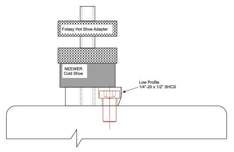

I use MacDraft Pro (2D, which is all I need):
https://www.microspot.com/index.htm
They have a PC version, also, as well as a Lite option (you lose some capabilities, but can still save/print/whatever). I used Lite initially then upgraded when I started doing more detailed drawings for Village Press publication. You can try for free for 14 days and they have a comparison "tool" on their website. I like the fact that it is an outright purchase and you only pay if they have a major software upgrade and you want it. If you buy the Lite then upgrade, you keep the Lite so can put that on a laptop if you want (I did).
While geared towards Architectural/Landscape/Construction, they do have "Electrical" and "Engineering" libraries (I have the Engineering library and use the fasteners from time to time if it makes things clearer in an enlarged or assembly plan).
I modified the standard symbol to create the low profile head version (in red).
They frequently have deals (their bundles are currently on sale), and will work with you on getting a good price on a custom package. I got a super deal on my upgrade to Pro plus the Engineering library (they sent me a link to the Electrical library by mistake and just told me to keep & use it if I wanted to and sent me the correct link).
