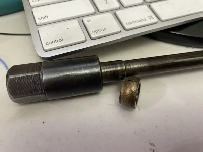

I think I found the problem. The drawbar spacer is crushed and the drawbar was not pulling the tool up enough. Sometimes it's just the simple things!!!!!

Also this drawbar is a replacement because the original had damaged threads, but I never checked the length vs. the original.

How did it get crushed like that?
Did you ever measure the torque you apply to the drawbar?
Another interesting question is how is your R8 alignment pin?

Well that's a good question. The spacer looks like it is bronze, about 2mm wall thickness with a crack along one side. When I said symptoms came on gradually, that would make sense as the crush became greater the drawbar exerted less force and things started to wobble. I use a 12" Kurt vice handle for the drawbar so that certainly limits the torque I can apply. I'd say the spacer was simply too weak. I replaced it with a new phosphor bronze sleeve with significantly greater thickness.

That I don't know. Probably me whacking on it to remove a tool with the threads partially engaged. The original drawbar with the rough thread was replaced about a year ago which lines up with the progressive symptoms. I noticed the excessive runout a couple of days ago, and just now when I picked up the spacer with the crack, it split in half. So basically the spacer suddenly failed, leading to the insecure fit of the R8 tooling. Anyway I'm a happy camper now. :)

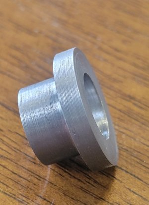

I'm not 100% sure that you guys have the same setup as I do, but consider making the spacer to look like this:
This design holds the drawbar in center of the spindle so it doesn't rattle at low speeds and accomodates adding plain washers to arbours that have shallow threading.
Here is a thread to explain the nuances. Your mill may be a bit different but maybe this will give you some ideas. For one thing, I cannot imagine a good reason for why your spacer is bronze. I'd be making that from steel if it were mine.
