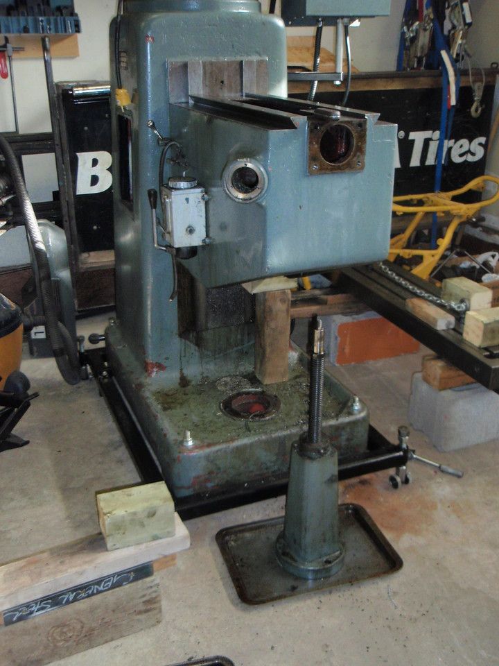

I will say that if I hadn't got a good deal on my mill I would have taken it back and got after my money. It was a flood coolant machine and was the most disgusting filthy mess I ever dealt with. Congealed coolant and fine swarf mixed makes an excellent cutting surface on moving parts, and I tried every solvent from varsol to MEK, but hand scraping was the only way to clean it out. Some areas such as the sump in the base will never be cleaned. I dumped 2 bags of floor dry in and put the plate back on.

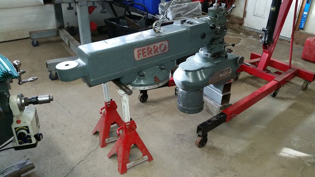

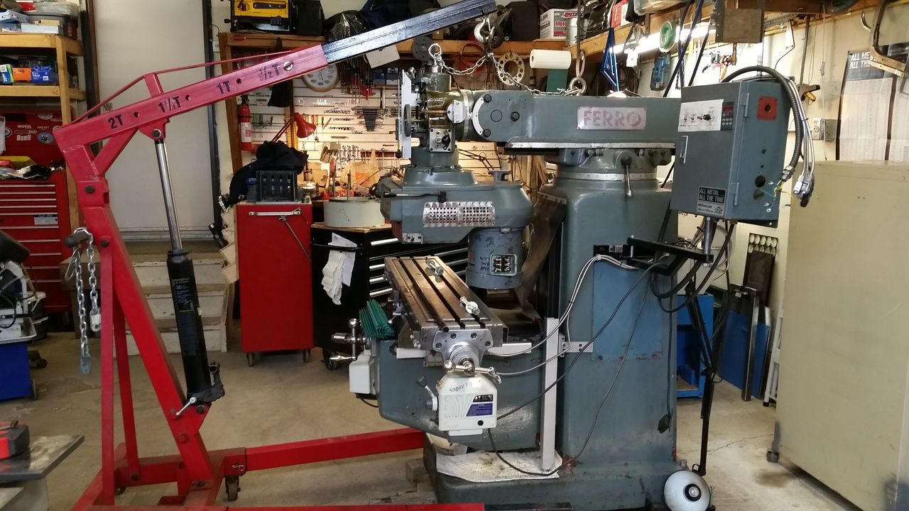

Ye this machine was used with flood coolant and it peeled some of the paint off and it's jelled onto bunch of the surfaces. Razor blade takes it off that's about it I've found so far lol. I would like to get misting set up in future I think as it doesn't look like a mess.
O ye as far as my sump is concerned I just pretend it doesn't exist ATM haven't felt need to empty and clean yet. That and there is still hole in my coolant return catch.
I use mostly vacuum and rag started using bit of air on table and rubber covers since I final got around to installing the factory dust boots.
But still prefer vacuum as the chips don't end up blown into oblivion across the shop. 16920637049301028339719121761240.jpg

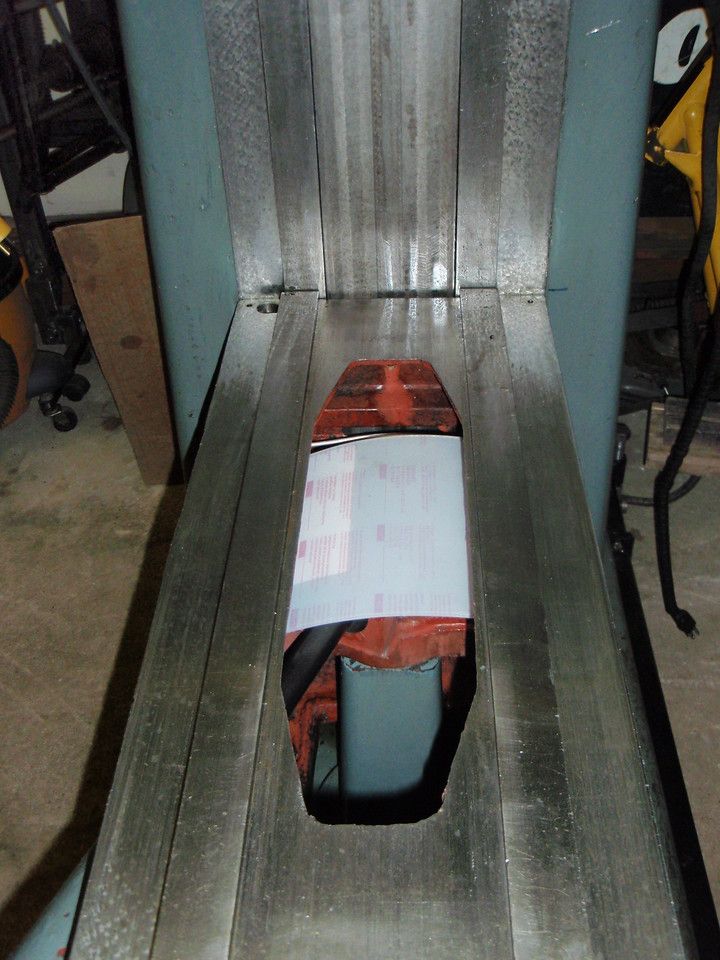

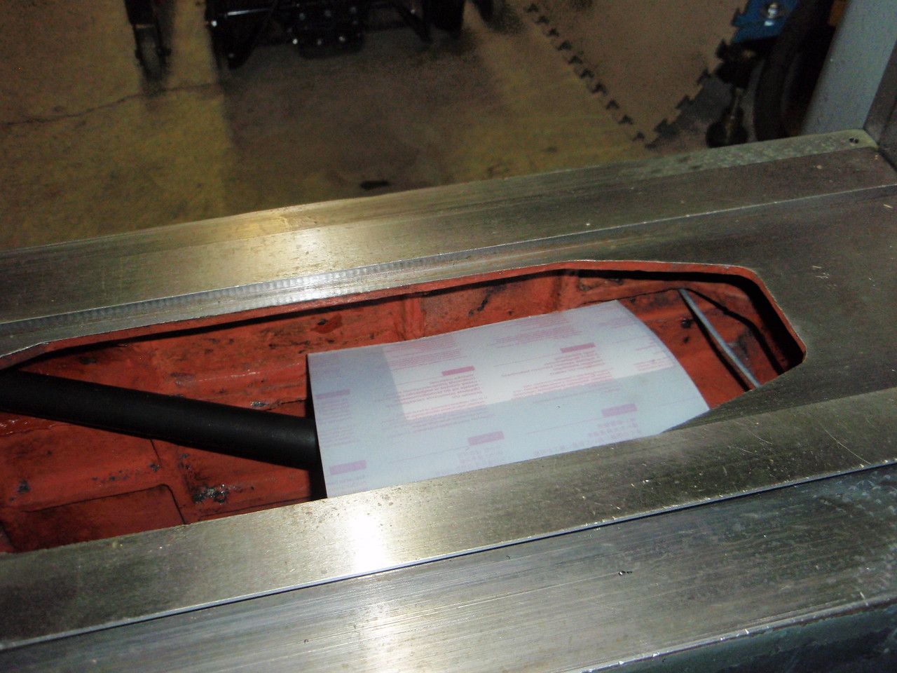

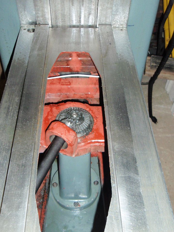

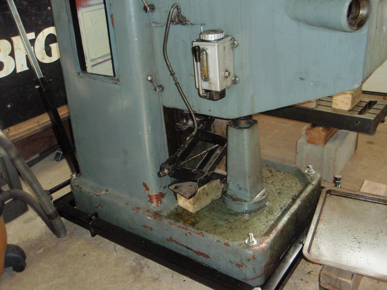

photos of the other crap I've tried for your viewing pleasure. In both instances, a bubbler and UV light purifier were running. Compared to the time and money wasted on the stuff below, this stuff is cheap. It sits for years, no purifier or bubbler, and just doesn't go bad.
The miracle of the digital communication age......save yourself pain by me sharing my experience (and pain!) :)
Taken Dec 22 2010
Taken Feb 13 2011
Try, try try again.....different crap coolant
taken march 15 2011
Taken Aug 30 2011
