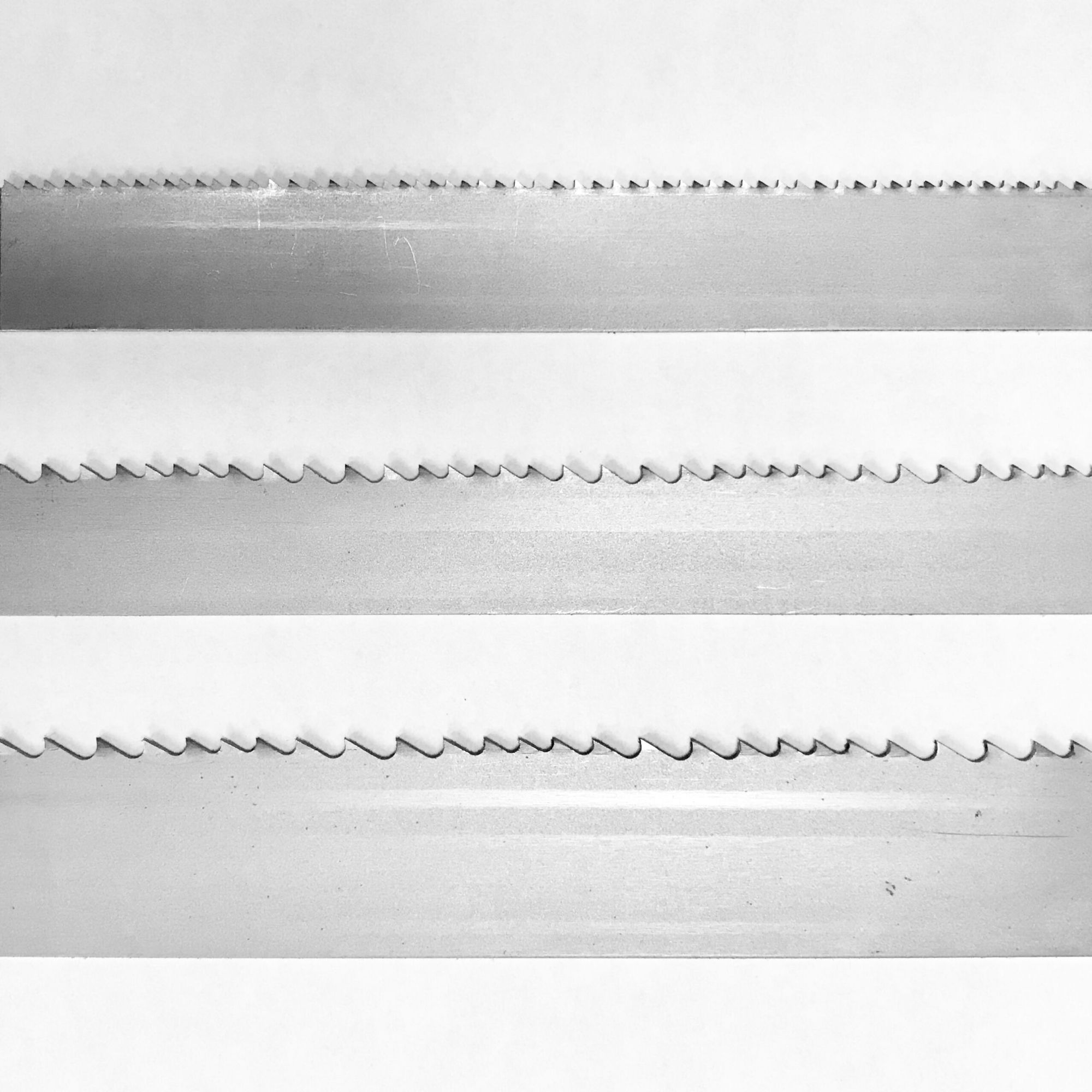

trlvn
I've used R&D Bandsaws for wood cutting blades for years. They also sell a couple of styles of metal cutting blades and I intend to snag one of those for my portable bandsaw:
I didn't check how much they'd charge you for shipping. They're based in Brampton, ON.

trlvn
Len:
R&D supplies all kinds of bandsaw blades including metal-cutting. The link I supplied is metal cutting blades.
