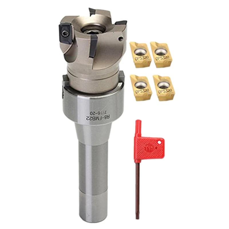

Here's the facemill I got for when I don't need a square corner. It's a real ripper, and the inserts are tremendous
an R8-FMB22-7-16 (for 7/16-20 drawbar) or R8-FMB22-M12 (for M12 drawbar) is required.

I also bought the one that Tom recommended. I use it a lot and have been so pleased with it's performance that I bought an assortment of the smaller sizes with integral straight shanks. The shanks are metric, so I turn them to the next smaller inch size to fit my collets.
These inserts are the best I have found so far.

What is the difference between a face mill that uses bap300r and bap400r. I can't find information explaining the difference and the pictures seem to all look identical to me. The only thing I found was a post where someone said one used the opposite corners of the insert than the other but left it vague. Does one not cut 90 degrees?

I can't say for certain, but basically it is the size. It may be the insert size, but they all mount the insert the same way and cut 90 deg.
