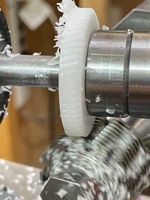

Here's a few pictures of the machine at this stage and some finished gears. If there's a way to upload videos, I'll post those too.

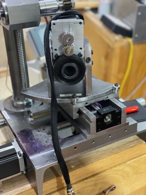

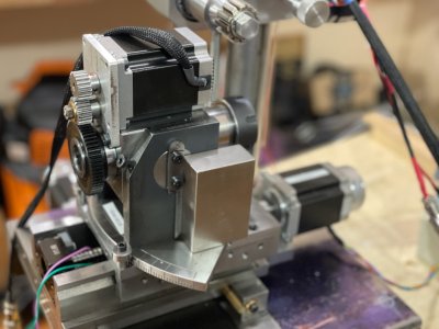

Setting the gear helix angle on the quadrant plate, and setting the tilt to zero using a 123 block
View attachment 64647View attachment 64646
The undercarriage showing the X ballscrew and the hob helix adjustment mechanism.
The micrometer allows 1' (1 minute) adjustment.
Cutting a 60T M0.6 helical gear and a similar spur gear. Left/Right helical and a pair of spur gears made from Delrin.
Small gears like these take about 2 minutes to hob.

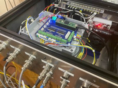

Custom electronics. Under the grey part are the 2M542 stepper drivers. There's a 24V 300W PSU plus a 5v and a 12v BEC.

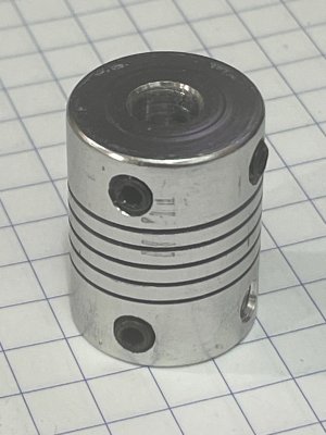

And the root cause of the vibration under high load.....
These things.
I used these couplers on the X and Y axes. They are fine for light duty rotary transmission - but axially, they are springs!
Under the light loads when cutting plastic and brass, any axial movement was not noticed, but when cutting steel it got ugly. As the cutter does it's thing there are radial and axial forces which moved the workhead in the X and Y directions.

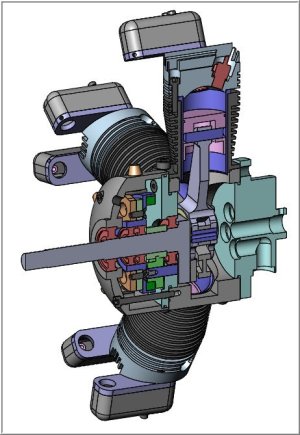

I was going to do a motion animation of my radial engine. I had it working on a single cylinder basis. It correctly handles the planetary gear reduction right through cam/pushrod/rocker/valve train which has a pretty funky mate chain. Theoretically it should have carried this to the other 4 cylinders but it 'digitally seized' - a bad omen LOL. There other settings I need to figure out. Maybe radially copying the jugs (more efficient assembly memory) had some side effects. I've seen some radial/rotary YouTube videos where I can spot some motion cheats, others look to be good. But I digress...

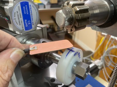

The second update was to add a touch-off probe so that the hob position touching the work can be set correctly (G54 equivalent). So that all works, the hob approaches, touches the probe, retracts 5.00mm and the work position is recorded. But my wobbly hands don't hold the probe in the correct attitude reliably. On these small gears, <M1.0, a thou or two makes a huge difference to the fit, so a more reliable method is needed and I'm looking for suggestions on how to make the touch-off process repeatable.
The probe is just a contact plate. I also have a touch button to signal the position when I visually jog into place, then I hit the button and the position is recorded. Parallax and old eyes aren't helping in that situation either.

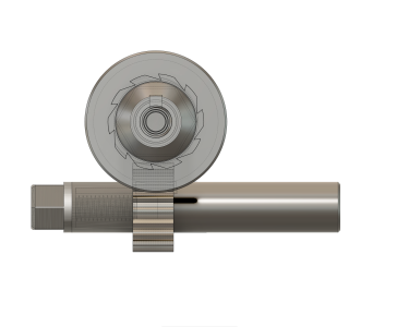

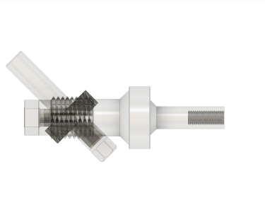

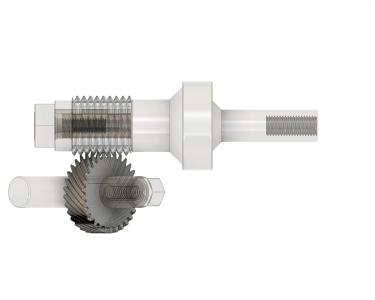

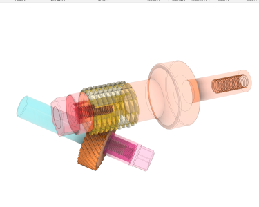

Here's the issue:
When cutting a spur gear, the hob and the work axis are at 90 degrees +/- the hob helix (e.g. 1.13 deg). When touching off, the contact point between the two cylinders is easy to find. Furthermore, any axial misalignment of the hob or the work makes no difference, the Z position is always the same.
When cutting helical gears, that is not true. There is a point of contact which we must find, and any misalignment of the hob and work axes affects both the depth of cut and the tooth profile to be hobbed.
The X position is along the length of the hob but since the blank lies at the helix angle, there is only one position on the curved surface which is exactly at the top.
The axial feed during cutting is in the Y direction - the gear axis.
The Z position must be found at the centre of the work top surface - at the correct X and mid-Y positions. This becomes the work datum.
Screenshot 2025-06-13 at 5.05.58 PM.pngScreenshot 2025-06-13 at 1.50.00 PM.pngScreenshot 2025-06-13 at 1.50.15 PM.png

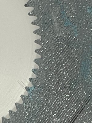

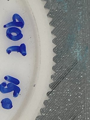

This is the result of a poorly aligned hob - the sides of the tooth have been shaved away by the hob, exaggerating the width, when the work and hob axes were offset slightly - maybe 5-10 thou in this example.
And the correct profile:
Stay tuned...

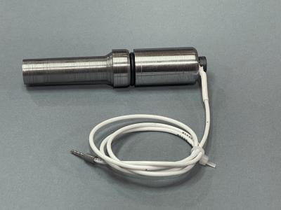

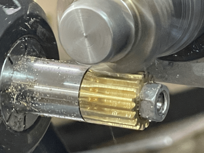

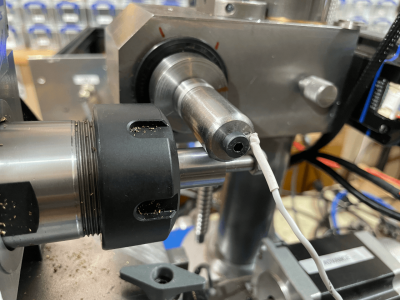

Lots of upgrades recently.

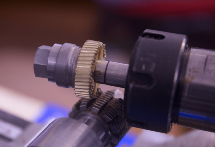

Thanks @Mike R for the probe suggestion. I reworked the software and the HMI to include an autoprobe function.
This is the electrical contact probe with a delrin insulating sleeve inside. The work arbor shaft size is also known, so the precise work axis to spindle axis position is known. It is a very repeatable and reliable system.
It really helps when making smaller gears like this m0.5 brass pinion.

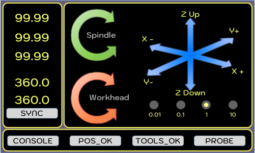

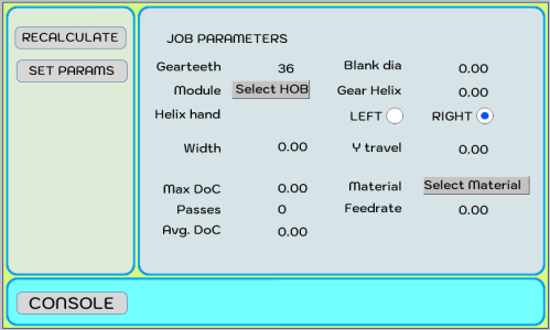

Most of the work this month has been fighting the HMI. The display I have been using is a Nextion "Intelligent" 800x480 capacitive touch screen. It is quite easy to use with the Teensy for most operations. The HMI has seven screens - the main Console, Jogging with DROs, Job setup, Machine setup, Material setup, Hob setup and Help. When changing screens, the application needs to remember what was displayed, change screens, display data and then when returning to the first screen, refresh the screen with the saved data. With the Nextion system the time needed to refresh the display is approximately 1 second which is completely unacceptable, since the machine may have changed state in that interval.
The issue was ultimately traced to how the Nextion handles Serial data, basically creating a parsing bottleneck on the display which I cannot work around easily. 4D Systems also make intelligent displays and I have had some good experiences with those in the past, So I pulled the trigger on a 5" 800x480 uLCD display programmed with VisiGenie.
The VisiGenie software is entirely different in concept and operation than the Nextion. The BHM application is independent of the HMI, so I began a complete refactoring which seems to be working so far.
Here's the Jog screen and the Job setup screen:
The SYNC button sets the relative rotational position of the work and the hob (index = 0) so that a repeatable starting position can be set.
PROBE starts the autoprobe sequence
TOOLS_OK signals that the hob and workpiece are loaded, after the PROBE cycle.
POS_OK is set when the hob and the blank are at the touch-off position.
Almost all of the calculations are performed in the background after the user parameters are entered. When the number of Gearteeth, Hob, Helix and Width are set, the gear can be fully defined. The blank diameter and Y travel are calculated. When the material is selected, the system will make an educated guess for the number of cutting passes and the optimal depth of cut per pass. These can be overridden by the user.
