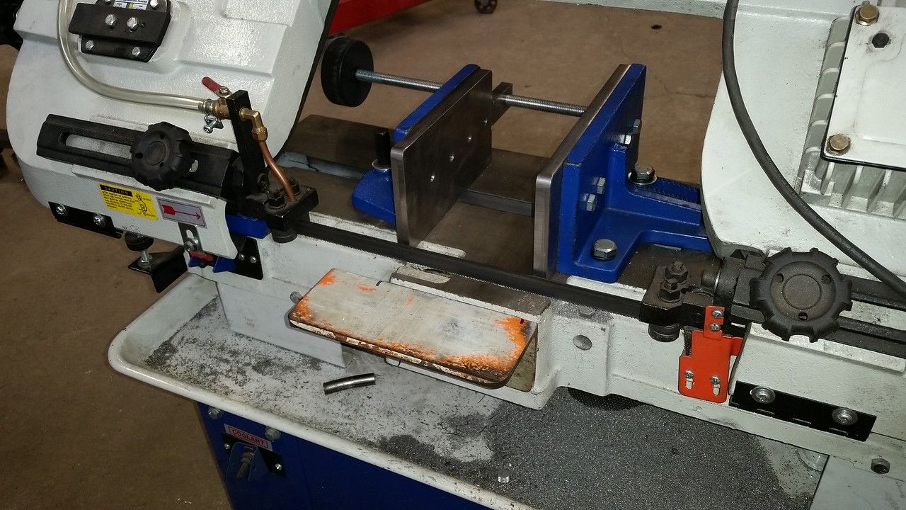

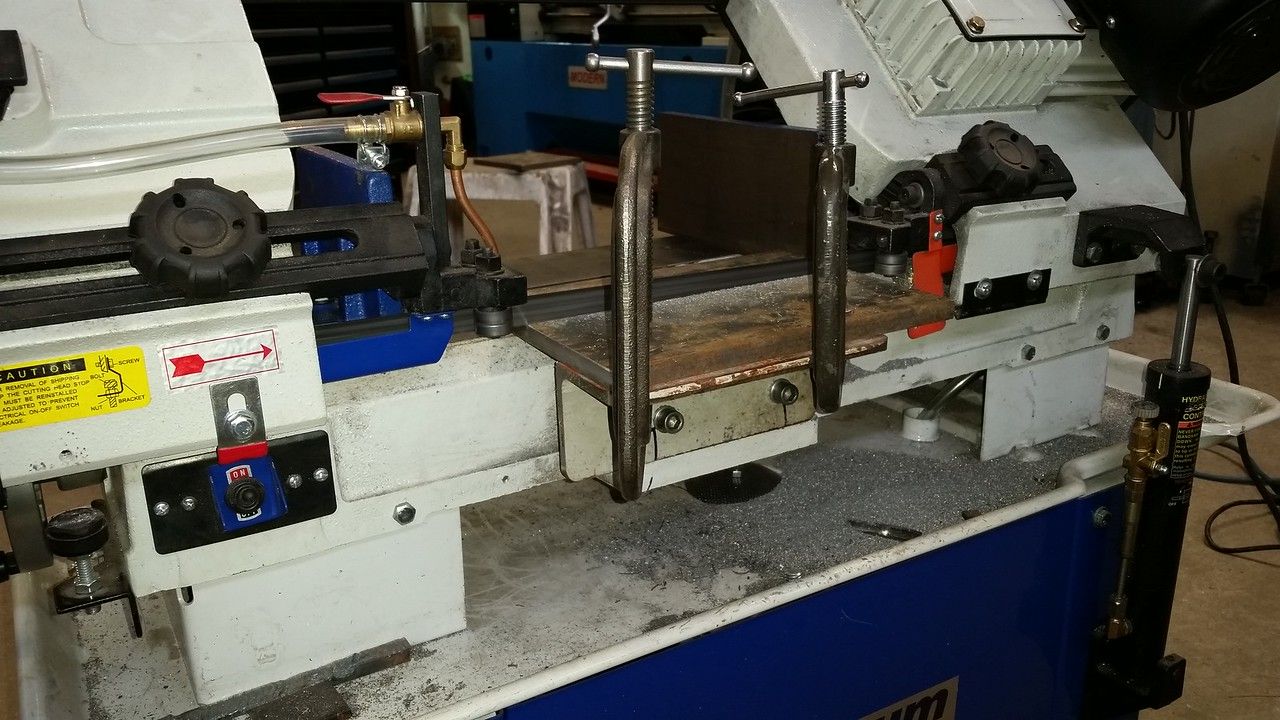

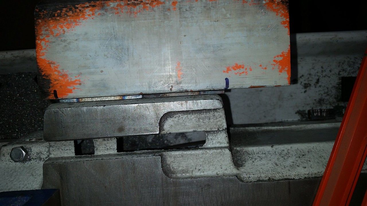

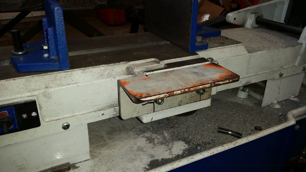

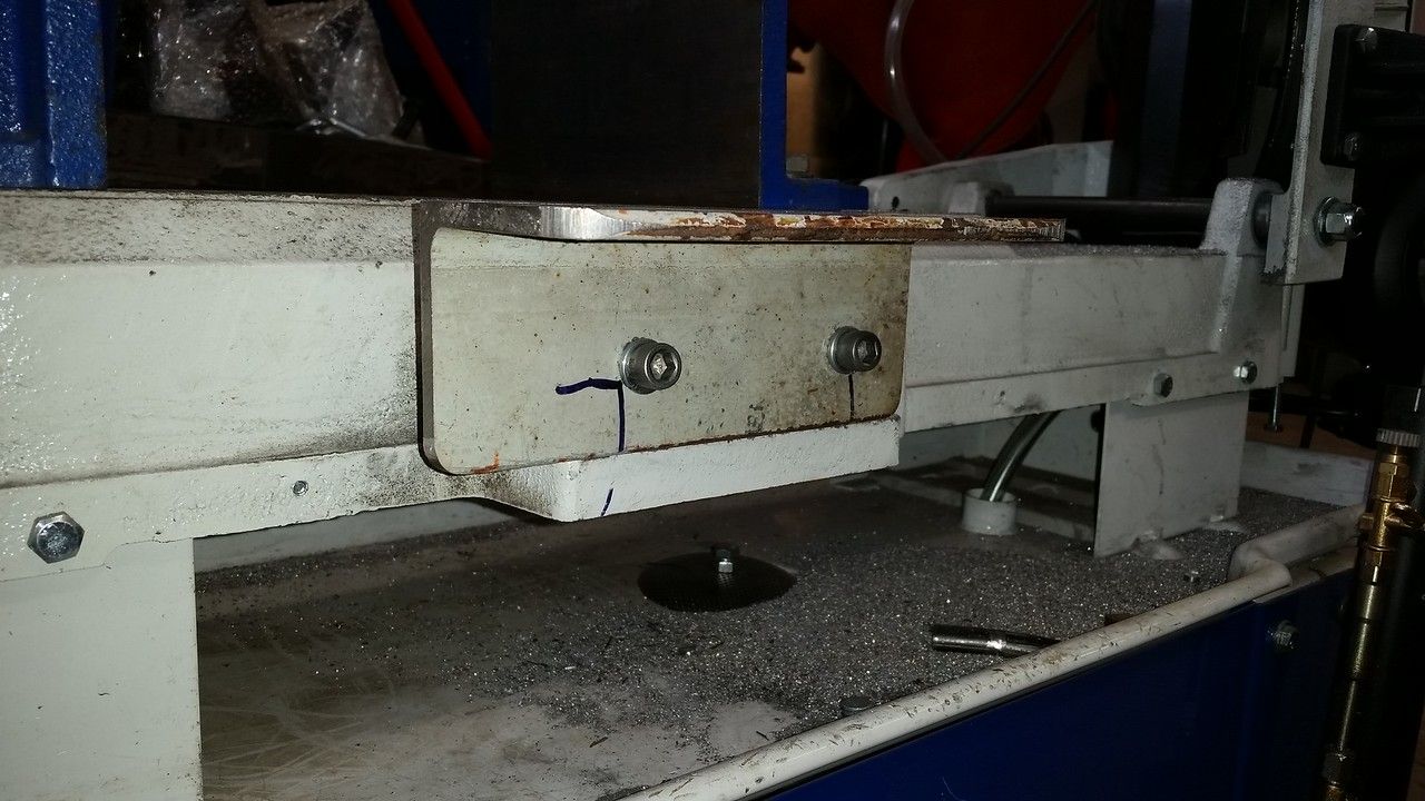

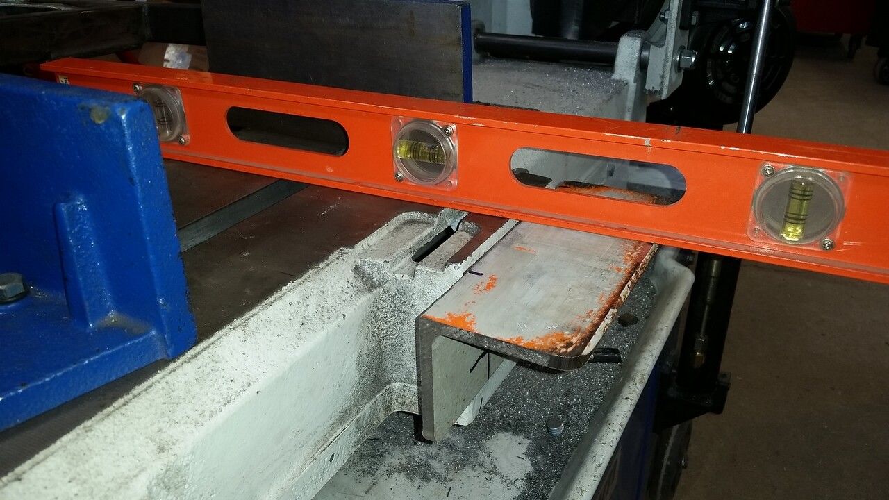

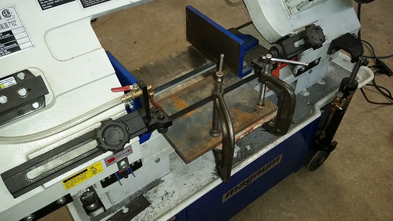

Here's my version of Janger's outfeed table. Pretty much a straight copy except for a couple of details. I used 3" X 3" X 1/4" angle too but to compensate for the angle of the saw casting I measured the gap at the top when the saw and the part were aligned. It was a little less than 1/8" so I button welded a piece of 1/8" X 1/2" flat bar to the table and by trial and error whittled it's thickness down until the alignment was spot on.
While I was at saw improvements I decided to add some of the mods shown in the links above. I have a piece of 1/2" X 7" hot rolled plate left over from another job so I used the new outfeed table to hold a couple of pieces length wise to rip them down to 4" wide, the same dimension as the jaws on my saw.

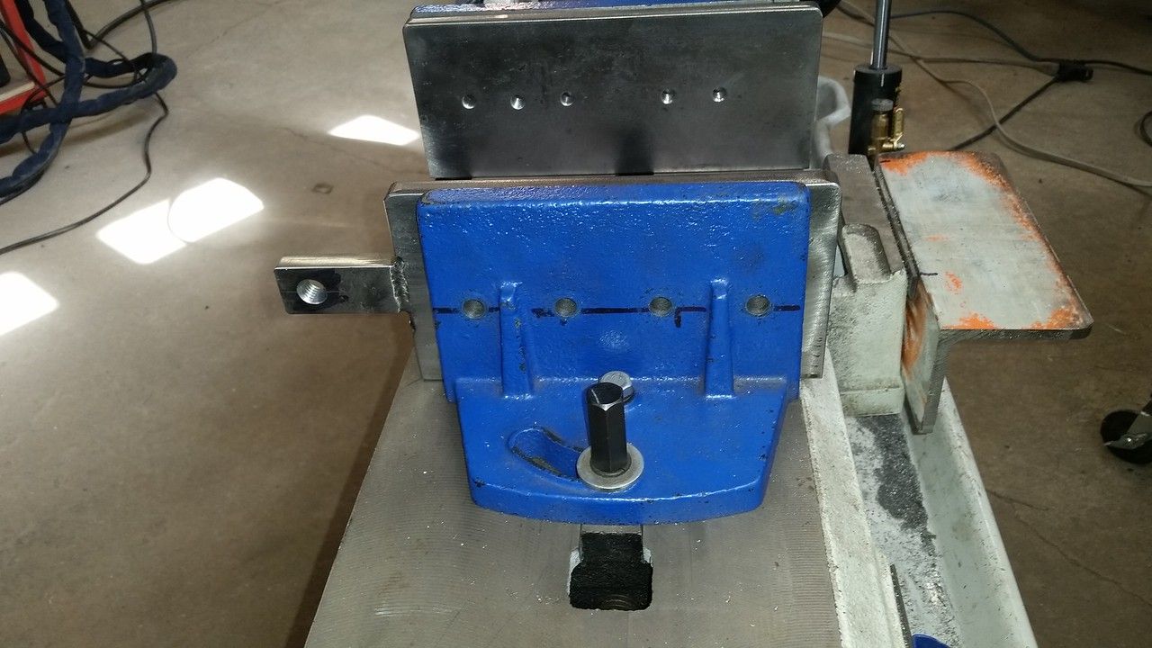

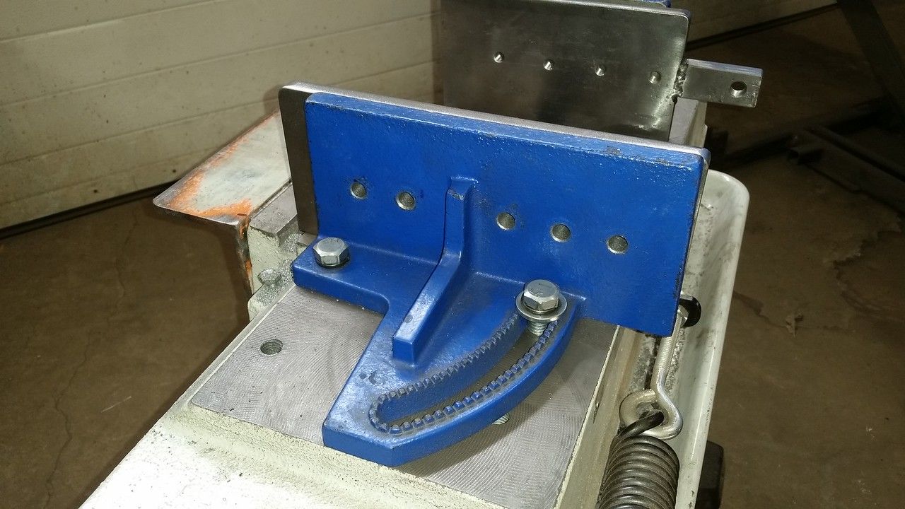

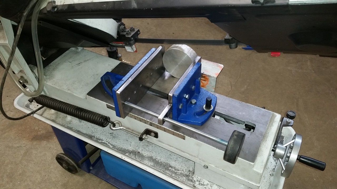

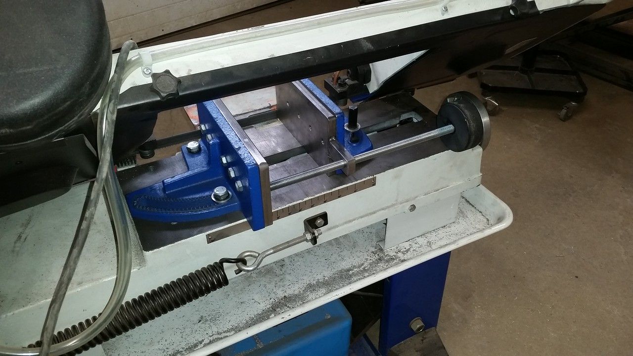

I drilled some 3/8" holes in both jaws and transfer punched, drilled and tapped corresponding holes in my extension jaws. I welded a tab on the movable jaw extension and tapped it to 1/2" 13tpi for the jacking screw. The jaw extensions are 1/4" from the blade when installed and work great for holding short pieces.
For the jacking screw I used a piece of 1/2" all thread rod and made a grip handle for it from a hockey puck. I drilled and tapped the center of the puck to 1/2" 13tpi and used Gorilla glue to bond it to the treads on the rod.

I really like the idea of the permanently attached table.
Excellent! Its how these saw jaws should have been designed to begin with. Although I get it - they assumed blade standoff was required when the jaws swivel for miter cuts. But 99% of my cuts are lopping off perpendicular so I'd rather have the jaws close. And because the plates are are bolt on/off its best of both worlds.
Unnecessary frill but this threaded portion could benefit from a quick nut (is that what they are called?). Only reason I mention is I was looking for similar hardware for another project & couldn't find them. Anybody know of a source? They would be a pita to make.
I think John has 700 hockey pucks to use up & this is application number 394! Great idea.
