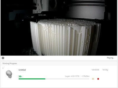

I noticed the same thing when I ran some generic PLA. Print times went up. I tried it at the Bambu settings and did not have reliable results. I think the 'generic high speed pla' setting is the happy medium i settled on with good results. I'll know tomorrow when my skull is done printing. So far so good with generic pla.

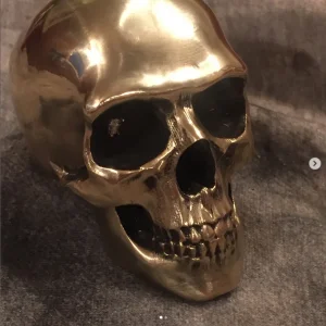

I know speed isn't everything but this printed flawlessly in 27 hours on my X1 Carbon using polycarbonate filament at .2 layer height.
All the presets for temps and speed were the default.

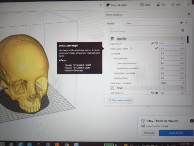

Try slicing it with your slicer to see what potential print time you get.
This is stock PLA settings with 0.2 layer height, 20%infill from my Anet profile.
Knowing that the #'s aren't that accurate I'd say that it would be a few hours longer than that, IF the printer could ever make it that far without crapping the print.
You're probably correct about that. I'm still learning here lol
I'm sure the regular supports will work just fine. In hindsight, I would probably print it in pieces next time.
Even the tree supports are a bitch to fish out of the skull through the neck and eye sockets.
I find myself sympathising with the ancient Egyptians.
I have a roll of support filament. But I'm not sure if this would be a good application for it. There would be a lot of filament changes. Even with flushing into infill enabled, on a print this long it would probably add considerable time to the print time. I should try slicing it just to see.
I have a roll of support filament but have never used it. Filament is still cheap enough that I'm not too worried about wastage.
Most of the smaller prints use just one type or color of filament so no flushing required. I'm running a 12 hour print right now of 65 separate items done with 2 colors but it still only flushes on the color change for each layer so the purge tower is the same size for 65 items as it is for one.

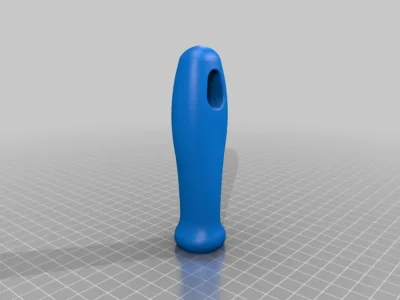

The time black hole sucked me in last night. I stayed up way too late trying different file handle designs I downloaded off line to see if I could find the best.
You can benefit from this. 🙂 I give my Brass(gold colored ) Stamp of Approval on this model of file handle.
Nice size in hand. Comes with three models with different tang sizes designed into handle. Prints nice.
Screenshot 2024-02-03 at 19-05-33 Ergonomic File Handle for Nicholson Files by PvtDBJackson D...webp
Very similar to the Nicholson file handle.
