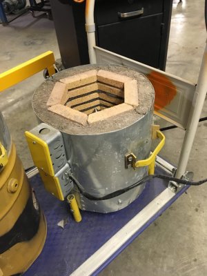

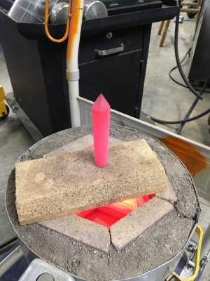

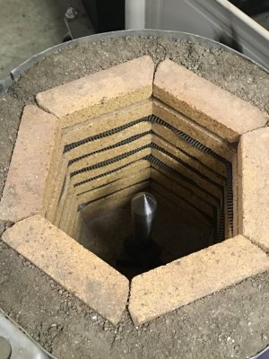

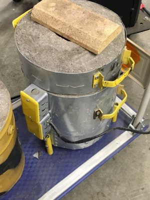

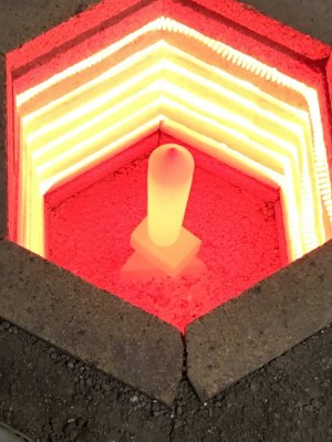

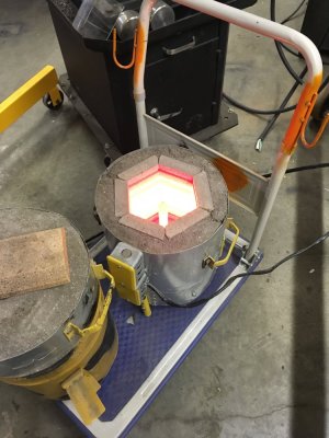

If you don’t mind me asking: where did you get your kiln? Make and model # perhaps? That is one area I am not set up well: heat treating.
I made my kiln for the purpose of melting aluminum/brass for casting
I followed a book (one of gingery) and ordered the element from budgetcastingsupply.com
I built the bases (top/bottom) as separate pieces and I have a propane fired middle section that u swap out in summer (Electric=indoors)
The kiln is made of firebrick (w/grooves cut on table saw) that hold the element, surrounded by refractory
1 hour, 15 minutes. The last picture is the center in the 'cooling' mode. The heat from the kiln will keep it warm for hours. Furnace will be glow for an hour after unplugging.
Yep, the plug is in a 220v 15 amp breaker, based on the length of heater wire, it draws juuuussst over 15 but it won't trip the breaker
It runs off a stove (think household stove) switch .those work on a principle of on/off cycles. Max= always on. I rarely use it on a setting other than max , but I'm going to use it for some lost pla plaster of Paris castings to melt the pla out of some molds
