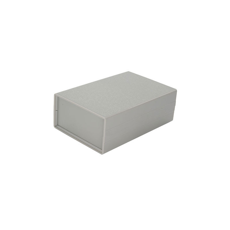

Btw, what project boxes do you like? I plan to sit it on top of the gearbox on my lathe until I get a DRO for it. Then it will move to my surface grinder.
This is the perfect case for the 16x2 lcd display, and the nano screw terminal board fits nicely. The only tricky bit is the orientation of the I2C leads on the display need to be perpendicular to the board.
For my original tach, I bolted a hard drive magnet to the bottom of the case to keep it in place on my lathe gear cover
For more involved builds I use these with a blank cover plate
Perfect. Thank you!
I never considered using an outdoor wall box! I was thinking bigger than that. But why? It's just some teeny tiny boards! Maybe I was just subconsciously worried about getting big hands in there.
I confess that I don't understand this point. Was I supposed to put the I2C board on the display side of the display board? I put it on the back....... Does it matter? The pins all go in the same solder holes either way. Or maybe I just think they do..... Oh oh.
the smaller case is quite close to the length of the 16x2 LCD. The typical I2C module has the four input pin parallel to the board. By the time you allow for the mating female wiring connector, it’s too wide to fit in the case. I try to get the modules without pins, or carefully bend the pins so the connector is perpendicular.
Ah, I see now. For some reason, my head was locked onto a display side issue. But it's really the overall length.
