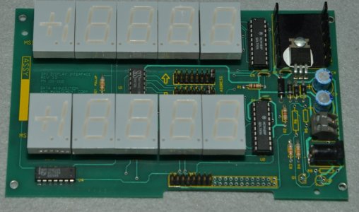

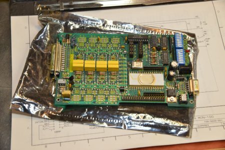

A few decades ago I designed a product that could have been the forerunner of the Arduino. The board had I/O, A/D, Serial. But the technology at the time was EPROMs so debugging had to be done with print statements. Integrated IDEs didn't really exist yet. But I wrote an RTOS for that processor and a colleague wrote the cross assembler and a Tiny Pascal Interpreter (the idea of Python).
The product was used in a few places but the EPROM need killed it. We had 7 Segment displays, 3 axis quadrature encoder boards, D/A boards. Serial was RS485 so we could network them. The RTOS found all the modules in ROM which could be written in either assembler or Pascal.
Shortly after I moved to The Netherlands and worked on OS9 based embedded systems with EPROMs but firm rules on how to code so others could read it. Again C code. But now State Machine Based. In the long run easier to debug than using an RTOS and for 99% of the control system fast enough.

So just to hijack this thread a bit more. Here's a photo of the electronics that runs my foundry furnace. To be precise only the middle board with the rust and corrosion is in use. The little DIP board with the two crystals is called a CANDIP and has an Atmel 8515 processor and a CAN chip on board. The software written in C does PWM to a transistor that runs the PA surplus motor which turns a fan. It does that spark coil on/off pulsing. (There's a story behind that for another time). And it opens/closes the gas solenoid.
Now the other board interfaces to that little glass tube driven with about 300V to detect ultraviolet light. If the flame is on there is UV. If the flame goes off it might be white hot inside the furnace (which would relight the gas) but no UV. And if the sensor was connected and the software enabled it would close the gas valve.
The other sensor, not visible because I moved the ribbon cable over it, is a hot wire anemometer. Two Thermocouples, one heated by a resistor and one in ambient air. The difference in temperature tells if there is air flowing since the resistor beside the thermocouple warms it up unless there is air flowing. Simple and we don't really care for an absolute air speed. Just did the fan stop turning?
I also painted the back of the fan with black and white paint and have a reflective sensor to determine fan speed but never even wrote software nor have pins for it.
