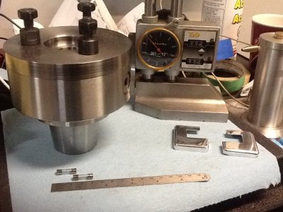

I own a Craftex 10x22 CX706, the front fuse is 10amp/250v, rear fuse is 15amp/250 v
What type of material are you machining for your chuck plate?
I machined a plate for my 5C collet chuck out of a cast iron disc that was from an old brake lathe we don't use anymore, I still have 2 discs if you need one, the cast iron is very nice for a chuck plate.
Thanks for the info Earl. That's interesting that your front fuse is a 15 amp. I blew a 6.3 amp fuse there and then ran a 10 amp for a long while but when I started my back plate project is when I smoked something. I was worried that the 10 amp fuse I put in was too big. I think the 6.3 amp fuse was something I stuck in but I don't remember what original was. The BACK fuse does actually have a label on machine calling for a 10 amp.
I'm turning a 6.75" chunk of 4140 (I believe) using carbide. It seems to make my lathe really grunt. That back plate you made looks beautiful and cast iron is no doubt the preferred material. I wish I had started with some. Oh well, now I've got parts on order from Busy Bee and I have to wait a MINIMUM of 3 months for them. I've had some terrifically poor luck in getting parts from Busy Bee.
