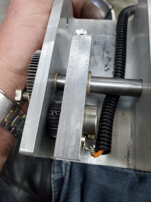

So I've been adapting an ancient old sewing machine from a clutch driven motor to a variable speed dc motor I salvaged from a treadmill. I want to use a foot driven potentiometer as the speed control. The original treadmill had a finger controlled potentiometer. I think I've got the basic mechanism figured out for the foot pedal to operate a crank which then in turn is suppose to operate the potentiometer.

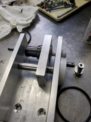

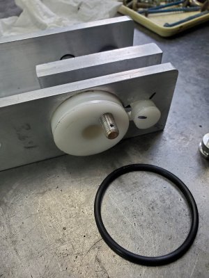

My first attempt was using gears (salvaged from an old drill) but the flex in the potentiometer shaft caused binding of the gears. After much frigging around I finally abandoned that idea and decided to try to make a belt driven wheel work in my contraption. Given the size and format of the overall foot operated mechanism I started with my wheels could only be a certain size. The wheel on the potentiometer is very small and doesn't have enough friction for the oring belt to provide consistent turning of the potentiometer. I used nylon for the gears. I've turned out a another small gear for the pot out of aluminum hoping that is would be less slippery than nylon but haven't tried that yet and do not have much hope for that either.
I think I'm probably going to have to go back to the drawing board. Part of my troubles is that I don't actually do any drawing but make up things as I go along trying to use materials and supplies I have on hand.
The only thing I can think of right now is adding some idler pulleys in the spots where the arrows point to increase belt tension on the little wheel. Part of the problem is the potentiometer isn't real smooth operating and has a rougher spot in its rotation. (New potentiometer too)

You should be able to use gears. I can't think of any good reason for there to be flex in the pot shaft. Belts (unless toothed) can slip, gears don't. If your gears are binding I would suspect something else - does the pot turn smoothly and work as expected when operated manually?

I tried an idler pulley to increase tension and have come to realize tension is likely the problem actually. I don't think the potentiometer was designed to have that sort of load on the little shaft. The potentiometer seems smooth when I rotate by hand but gets a rough spot in it when the belt is on.

A belt will put a side load on the pot shaft. If you are able to use a gear of any sort, that should be pretty strictly a rotating load.

Why not make a shaft extender for the pot that then rides in a bushing opposite the pot. Now you won't be pulling on the pot in a way that causes it to bind.
Or maybe even two bearings with the gear or pulley between them. Then all the load is handled by the bushings or bearings. The pot can even be coupled with a piece of plastic hose to avoid stressing the bushing in it.

Yup I should have done that.
I spent so dang much time figuring out how to make a crank arm and crank shaft to work with the original big mounted pedal on this machine and wanted to reuse the treadmill potentiometer.
