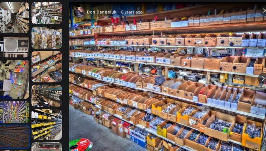

Side note 2
When I was living in Mississauga there was a surplus electronic shop (A1) 15 minute drive from home, he would sell new start/run capacitors for $5-10 each, I asked him how many do you sell, he stated more than you can imagine sometimes 10-20 a day especially when it's hot and everyone's A/C won't start.
Same capacitor at the local rake em over the coals electrical distributor that first question is "business name or account number?" Over $100 and I will need a specific model number and it will most likely be a special order.
Amazon is likely your best option unless you have the equivalent of A1 near you. The only thing I miss from the GTA is A1 and the fantastic ethnic food.
