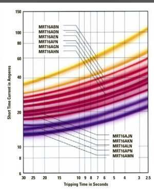

Yeah we tried that at the shop. They had 15 or so examples of the Klixon brand, none had the mounting ears, all were $130+. The sizing worksheet for the Klixon switches is quite involved and specifically says that it is not possible to select a Klixon protector based on horsepower, amperage or nameplate data.

Took the above from the first link. Once the switch is out of the motor you could carefully test it's function with a heat gun, thermostat, and meter set to ohms.
Edit: Without knowing the your motor's thermal switch exact ratings but using the ratings above as a rough guide - "120F open and close at 745F (+/- 5-12F)".

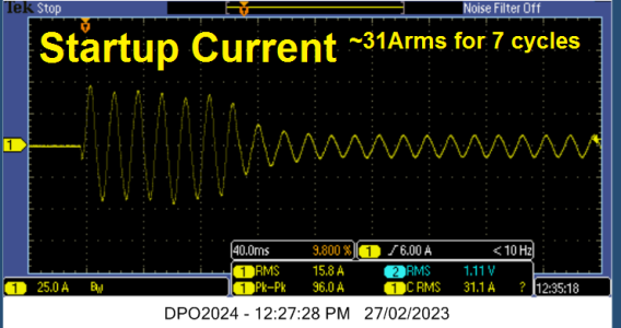

It states 17.x A
On start-up it should pull that many but not more if all is right?
Incorrect, it will pull much higher current for a short time while the motor is coming up to speed, 80A (wild guess). However depending on the response time of the meter you won't see it, you need a C.T. And scope to see that transient current.

First time starting today in a 22 Celsius room with an empty tank. The start current was 30 amps. Within 2-3 seconds the current dropped to about 11 amps and stayed close to that for the duration.
Let the pressure build to about 50 PSI and shut it off. Waited a few seconds, turned it back on, and start current was 28 amps. Within 2-3 seconds it dropped to 11 amps. As the gauge neared 100 PSI the current gradually increased to about 12.6 amps. Manually shut it off at 100 PSI. Max pressure before auto shut-off is 125 PSI.
