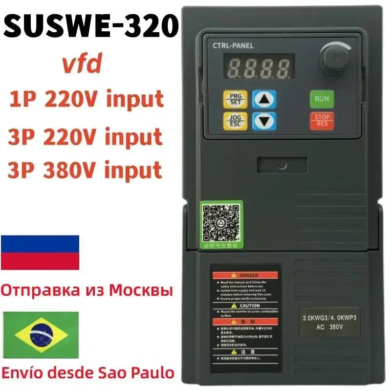

Then you can buy a VFD for pretty cheap aswell for 5hp or less motors. if you don't mind Chinese goods. Perk of VFD it gives you built in speed controller.
I've bought all my VFDs from this seller and been fairly happy with them. The manual is in all Chinese that comes with unit. but they will send you PDF of English manual if you ask for one via chat.
