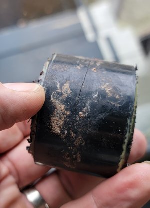

That's what makes this so weird. Mine are not failing at the stress point or the glue line. They are failing in the couplers.

Here is a shot of the failed coupler. The stains are the result of the leak.

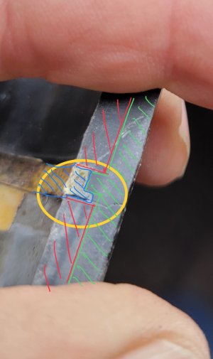

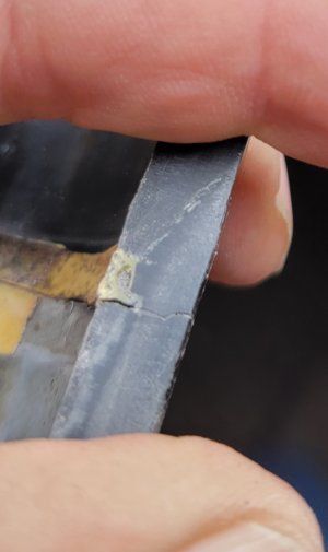

Here is a section through the straight coupler. Ignore the lengthwise gradient. It's just an artifact of my efforts to polish the sample in order to see the crack and the material around it better.
I don't see anything to suggest that the solvent damaged the integrity of the coupler. It still looks like substandard quality and/or excessive stress to me.

IDK…
Legend: (it was hard to see exactly where each part of the glued assembly is. Maybe using some liquid to wet the ABS might show the glue line between the pipe and the coupler better?).
blue => glue
green => coupler
red => pipes
Look at the interface between the pipe and the shoulder of the coupler… looks like the pipe coming from the bottom in the picture did not make it all the way to the center shoulder (ie, it did not bottom out) on assembly leaving a glue puddle. The crack emanates right from that area out. Bet that puddle of glue was on the bottom of the coupler as assembled in the run.
If my observation is correct, it could be a failure because of excess glue - as discussed in posts above.
If you have another failed joint you could cross-section, see if it looks the same.
blue => glue
green => coupler
red => pipes
If you make the green fatter and red thinner to end where your blue is, that would be about right.
But yes, the crack starts where the pipe didn't fully seat.
I had thought perhaps the shorter engagement might have put more cantilever anchor forces on the coupling and stressed it excessively. But I've glued a lot of ABS in my life and can't always get the pipe all the way in. It's never been a problem before.

If an excessive amount of ABS cement was used during assembly, and the pipe was not fully inserted into the fittings, might there have been large pools of ABS cement which would have weakened the ABS fittings.
I don't know what to make of this. Yes, the regular connection that I sectioned was not fully seated and yes there was excess cement pooled up there. But I can't really see why that would weaken the connector.
