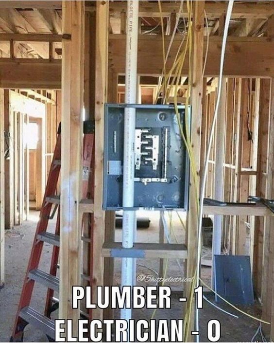

You know that each of the trades that comes along after the other goes out of their way to make the job easier by putting their work on top don't you (j/k...).
not my photo, but it made me chuckle (and groan)
That's too funny. Isn't this a steel bar (anti-drill-through plate)? We don't want a drywall screw making a leak in my pipe, but what you do 6" up from that is your own business LOL

Maybe its one of those staged gags vs a real installation, but funny nonetheless. I've watched too many of those catch a crooked contractor reality shows, nothing surprises me
