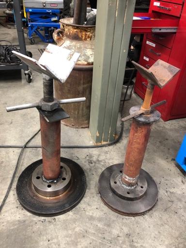

I’m using this (you wanted to see bad welding!)
Old brake rotors, tele-posts, ready rod ....

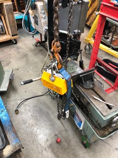

And I use the magnet/gantry to move larger materials

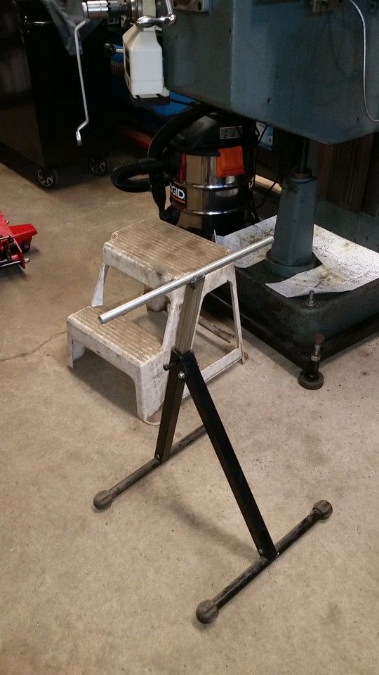

I have one of these.
It was too low before I built my new saw stand but now it works great.
I have Sharpie lines drawn on centre tube to mark the heights needed for the band saw and table saw.

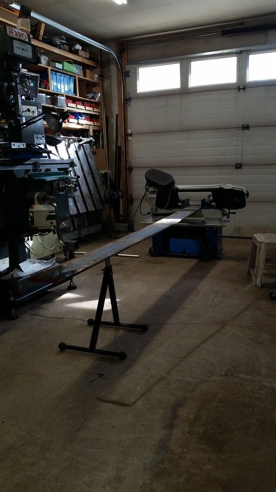

member
Mine started out as a King brand from KMS. It had a roller on the top but I didn't like that so I replaced it with a piece of tubing. It's height adjustable with a pinch bolt. The best thing about it is that it takes up no space when not in use. I had to cut about 2 inches off the uprights so it is short enough for my horizontal saw.
https://www.kmstools.com/king-canada-adjustable-roller-stand-106197
Strong enough for some pretty beefy stuff. This a 10 foot length of 1/2" X 7" steel.
