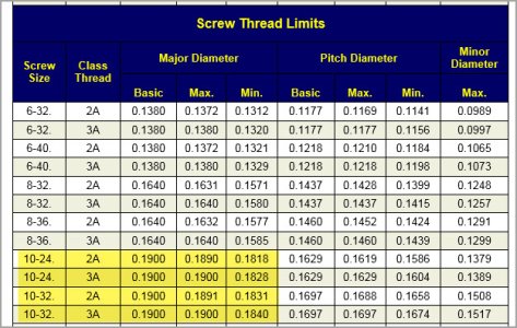

Working on sorting out my fasteners and I came across a weird item I never noticed before.
I have some bolts in a box sold as 3/16" bolts.
That was fine until I noticed I did not make a drawer for the same. That's odd as my drawers are a perfect match to my tap and die set.
Quick check confirmed that I do not have a 3/16" tap or die.
Quick testing shows that these bolts thread into 10-24 nuts just fine. Ok so that's odd too.
Review my tap and die drill chart and it doesn't even list 3/16.
I found another chart online and it has both listed together. It reads that 10-24 is .0025" larger in diameter, but basically identical otherwise.
Are these interchangeable with each other? Or in theory is it a disaster waiting to happen?
Thoughts?
JW
Just checked my mastercraft T/D set and its tap drill chart, same here, but I'm pretty sure they are the same, I believe I asked this once of my mentor and simple answer was; one and the same. Something to do with calling them machine screws and how; three sixteenths, twenty four, is longer than; ten twenty four. I just let it go at that but I would love more clarity if it's offered
3/16 = 0.1875". Unfortunately the box labeling is not really helpful is it?
A #10 shank machine screw has a range of nominal OD's depending on the pitch & thread class. I highlighted all the #10's just to show the range: from low of 0.1818" to high of 0.1900" which encompasses 0.1875". But that's just referring to shank OD. Tap drill size & tap type & % of resultant engaged thread is a different thing again. So I guess the answer is 'it depends'. 🙂
