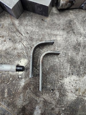

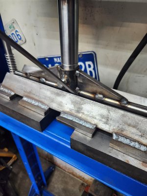

Perfect lol. Not sure what happened here. Too sharp of a punch?
If you consult the reference library of the internet you should be able to find tables of minimum bend radius for materials & material thicknesses. If I recall, a typical inside bend radius (nose of the die) should be somewhere near 1.5X thickness but really it depends on the material. E.g. in aluminum, you can get away with a tighter bend radius with 5052-H32 than 6061-T6 just because 5052 has a greater elongation before break property.
Usually, you either use thinner material, or you "pack" the nose of the press die with material to provide a larger radius around which to bend.

In the shops I last worked in, we usually had access to brakes with a selection of nose radii to pick and choose from. In the odd occasion that we did not have the radius desired, or if we were deployed and only had the basic brake to work with, with a square edge on it, we used strips of 1100 Aluminum (pure Al), usually 1/16 inch or .063 thou, by a couple inches wide, and built up a set of liners that could be stacked to get the Rad. desired. You could get some life out of a set of strips, and when they got too worked out to be convenient, they got turfed in the can, and a new set made up.
FWIW, the Sharpie annealing trick comes in really handy, when you want to bend a tight angle on higher temper sheet (6061-T6, for eg.). A variation, when gas welding aluminum, is to 'soot' the surface with an acetylene flame, then heat it until the soot burns off. Handy for annealing stuff that you are hammer-forming, or otherwise work-hardening.

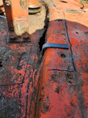

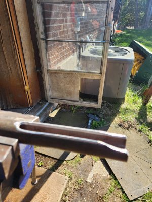

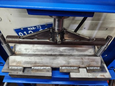

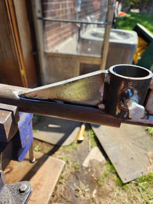

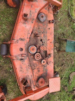

Well the time came that I needed to make some more tooling for this. I need to weld in a few patches to my mower deck, and needed a radiused punch. Some scrap pile brainstorming and I came up with this.
The gussets are from my "bucket o gusets" left over from my forge firepot I think. I can't throw anything away lol.
Quick weld job and it was time to test it out.
Damn....To small. If only there was something I could slip over this to make the radius bigger.....

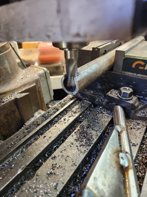

Another test bend. I have an idea for guides, but not sure I'll even need them. Will hold off machining them for now. The slip on pipe was planned from the start. Trying to make it as versatile as possible.

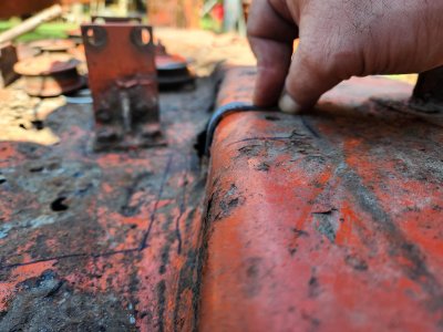

Close enough. It's a mower deck, not a Concours Bugatti.
Now the fun part......
Ughhhh. Will get started after dinner. I've been searching for a better deck for a while (was supposed to do this LAST winter), dreading having to patch this one up, but there's not much out there around here. It's not toooooo bad, but I'd rather start with something better. I know one will present itself on marketplace for $100, a week after I finish this one, and it'll be right down the road no doubt. I have another one in the barn, but it's rotten in all the same places too lol. This is fun right? Right?

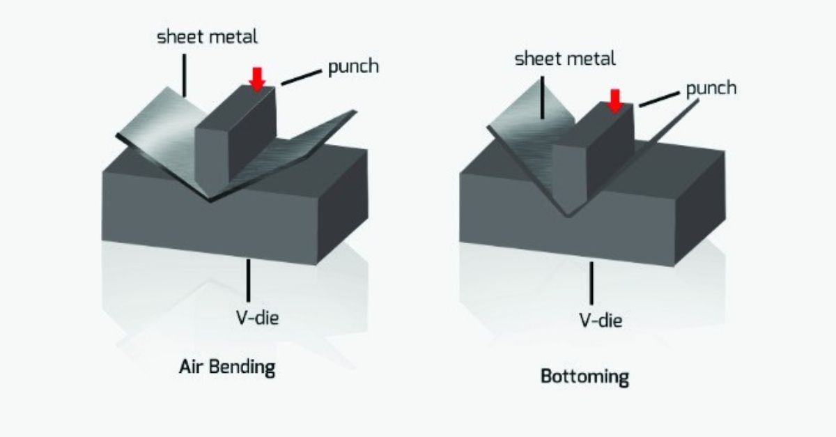

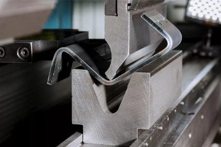

In saying you have no experience with this stuff, I didn't notice this before, or would have piped up earlier on the die design. Most brake work is air bends, meaning the material touches at the two edges of the die (usually rounded over) and the punch. Ergo, you want a die that is acute not 90. Its also best with round bar at the apexes rather than a sharp corner.
You can over bend to account for spring back and it takes less force. The coining action of a bottom bend (so you don't get spring back) is afaik more for really thin stuff and takes a precise die with lots of tonnage. Never done it, all ours, and all other fab shops I've seen use air bending (afaik). (Ours is cnc on the back gauge and down stroke, but really fancy ones sense the bend angle and compensate in various ways including pre-loading the bed into an arch and altering the ram depth). An air bending die will have a large radius in the bottom so as to not have a stress riser ..... can't have that with a bottoming die, at least not more than the bend radius which is usually not large.
We occasionally make one for some special requirement, like the 2nd photo below, which could be scaled down. There is no angled side to the die as with an air bend, material doesn't touch there.
getting-back-to-air-forming-and-bending-basics-on-the-press-brake-1666890018-1300x867.jpg
Thanks for the pics, and explanation,makes sense. I actually wanted to build a die like shown in your bottom picture. Probably will at some point. Or maybe just when I need it. I have an idea for something that will sit in my current lower die and work similar. I'll play around with it tomorrow, as I have the whole day to fix the mower deck and bend up some patch panels.

Any who....Reading back through this I revisited those 3d printed brake inserts, and have one printing now. All without getting up from the couch. Techanolagia!
