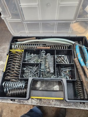

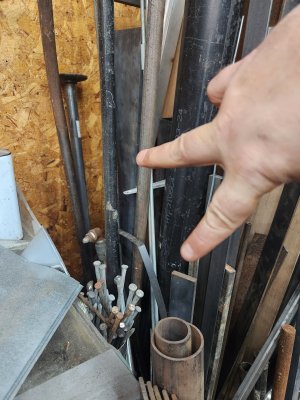

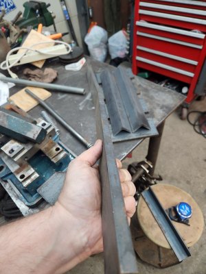

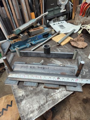

I decided to force my hand and just go out and see what the scrap pile said....

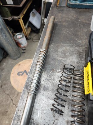

Started with my springs to see what I had, then found a bent 3/4" bar that had a enough straight sections, then found a pipe that slipped over that...one thing led to another.....

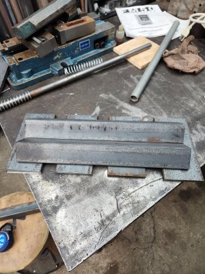

Then I found some 3/8"x3.5" flat bar to make the base

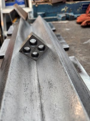

Some angle to make the vee
Next was decision time. The larger 3/4"x4" bar in the back, or the smaller 1/2"x2" one in the front.....
Smaller 1/2"x2" won. Need to save the bigger one for something else more important lol
Just enough straight section for the 16" I needed. I rescue a lot of steel from abusive homes it would seem......
A few more cuts, and here we are. Not bad for about 35 minutes of playing around.
Not super heavy duty, but should do about 80% of what I want. Things like 1"-2"x1/4 flatbar, and 10ga-1/8" plates the full width (might be a stretch for that) Gotta remember it's a hand crank press too, so.....
Probably wont get it cleaned up and welded out until the weekend, but the fun part is done.
Looks awesome already! I think you'll be quite surprised with what it will bend, I've done 6"+ 1/4" plate and I think ~ 3-4" 3/8 plate with mine on a 12t press. 2" 1/4 flat bar will bend on yours like it's not even there.
Thanks. I'm Looking forward to having some thick bending capability in the shop. I'm sure i'll find even more uses for it once I have it.

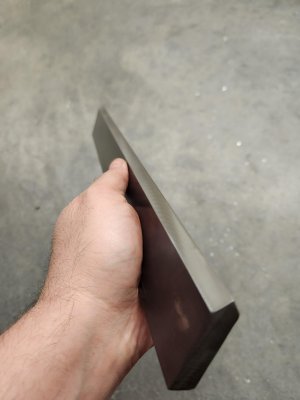

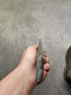

Finally got the punch machined
Machined to 88*. I should be able to get it welded up and finished this weekend. Hopefully. We're supposed to get a bunch of snow so I imagine we'll spend most of the weekend on the ski hill. 😀
Yes, there's a slight bend in it. I machined it clamped to the table, so the vee follows the bend. I'll wait until after I weld it up before trying to straighten it as that'll probably warp it some too. With any luck it might come out perfect 😀

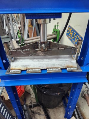

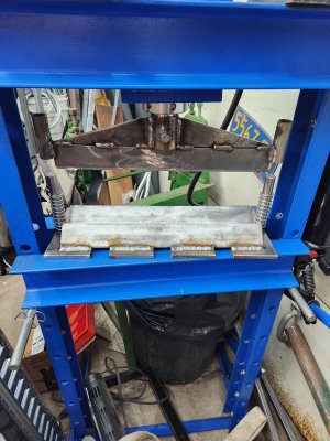

It's all done 'cept a bit of cleanup and fiddling, and paint. Not a lot of progress pics. Between my immune system all weekend barely staying ahead of whatever has kept my Wife down for the past 2 weeks, and the tumble I took down the skihill earlier today It was all I could do just to keep moving and get it done. Time to hold the couch down until bedtime.

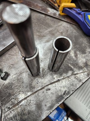

I slotted the bushings and pinched them in a vise to tighten them up a bit on the guides.

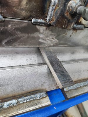

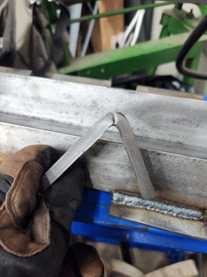

Grabbed a chunk of 3/8"x 1" form the chip pan of the saw, and gave it a try.
Perfect lol. Not sure what happened here. Too sharp of a punch?
Wife called me for dinner just as I was taking that picture, so I didn't try anything else. Won't be going back out tonight, but I'm looking forward to give it a whirl on a few different things later when I get some time.
Slowly chipping away at the unfinished projects pile.....

Might be too sharp or might have pushed too much into it. Looks awesome tho!
I noticed mine will deform it in the middle if I push into it too much and that's with a 12t and soft edge so I'd imagine yours would shear anything fairly narrow lol
Do some reading about "K factor" for bends, and how it is calculated. It has to do with the thickness of the material, and calculating the Bend allowance, so you can get the end dimensions you want, without always making it too long and cutting it down every time...
IMO, you did well to get that thick of material, that far bent, before a blowout. Even if the material is dead soft. Eventually the stretch on one side, or the compression on the other, plus work hardening from the metal movement, does the part in.
You can soften the bend area, by drawing a line where the bend will go, with a Sharpie marker, then heat that line with a torch until the line fades away. A useful way to make tight bends on -T3, -T4, and -T6 sheet stock, when bending in a brake.
Usually, you either use thinner material, or you "pack" the nose of the press die with material to provide a larger radius around which to bend.
