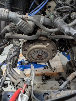

This likely has a dual mass but I'll find out tomorrow. It will be a single mass going back in.
@slow-poke 277K on the clock.

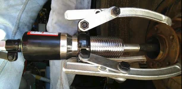

Ordered this 15 ton hydraulic puller to see if I can get the stuck passenger side axle out.
Interesting David. I'll. Be curious to know how that works. I have similar pullers in 2 and 3 jaw. I find that even if I oil the center screw, they often load up so badly that you just know that one more turn, will send the whole outfit to the scrap pile. Tightening the screw and then using hydraulics might be just the ticket. Please keep us posted.
I saw it last night in a video where a guy used a 10T version to remove rear axles from a BMW E61 that lived in the NE US so rust was a big factor. Took the press, heat, PB Blaster and a lot of patience.
The video is 41 minutes long and parts are sped up so I expect it took well over an hour or more.

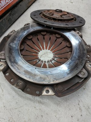

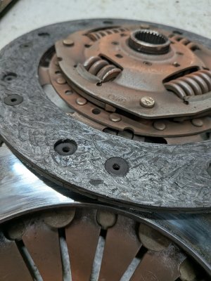

Pressure plate and friction plate. Friction plate is 5.35mm thick, basically down to the rivits. New one is 8.37mm thick.

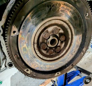

Flywheel. Single mass apparently. Makes me think this is the second clutch and I'm installing the third.
hmmm.....
- It's been a little warm, but at least no heat cracks
- might be cheaper to resurface than replace?
- as badly worn as it is, does not explain no forward motion when in gear?
- I'm curious, diameter of disc?

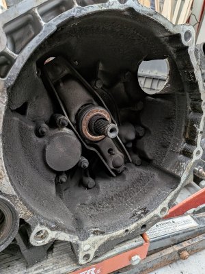

- Often crankshaft flange holes open to the crankcase so use locktite
New Luk flywheel is only $60. Don't think it's worth the time and effort to try and find a local place that would resurface it.
New Luk pressure plate and friction disk is $220.
There was a tiny bit of movement but not enough to actually roll the car.
Friction disk is 8.5" diameter
As blue as that flywheel & pressure plate are, I personally wouldn’t be reusing them.
But given how easy they are to access …
I've got a puller if you want to pop over and borrow it. If not a slide hammer with a finger hook can work. Never had luck with the grease trick
I have had great success with the grease method, ideally the bolt you use should be just smaller than the hole, then a couple wraps of electrical tape. Enough that when you drive it with a hammer the outside wrap or two get scraped off....
