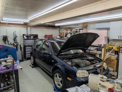

2002 VW Golf refurb

Swapped the wheels out on the Golf and got the front up on jackstands tonight.
For sh!ts and giggles I removed the passenger side top strut retaining nut and the whole thing just dropped about 3 inches. Loosened the pinch bolt on the steering knuckle and to my very great surprise I was able to easily twist the strut. If it weren't for the axle hitting the subframe and preventing the control arm from dropping more I would have had the strut out.

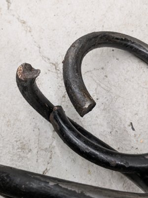

Pulled both front struts this afternoon.
To say they needed replacing is a major understatement.
The damper rods sink to the bottom under their own weight. And the left side spring was broken.

The front springs on my Jetta wagon did the same.
Maybe a common VW failure?
I've never heard of another make with catastrophic coil spring failure.
Interesting. I've not encountered this before either.
While not a coil spring, ford pickups had a torsion bar in the front end, a parts guy I knew at a dealership said they couldn’t even get the trucks off the car carrier without at least one breaking a torsion bar. They had 2 trucks on the lot they couldn’t sell as had run out of replacement bars, were waiting for more.
Am not sure how common it is, but have seen a few dodge pickups with a broken front coil spring, a couple of 1500’s, a couple of 3500’s. 2 wheel drive and 4X4’s.
